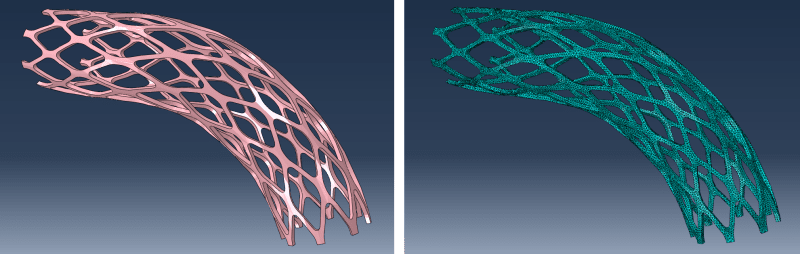

I'm new to Abaqus so sorry if my problem is trivial. I need to perform analysis of vascular stent deployed into artery (reconstructed based on actual patient imaging data. My original plan was to extract artery centerline, align model of stent to such centerline to be able to initially place it inside artery and then import both stent and artery into Abaqus to simulate opening of a stent. Operations on stent model to align it with centerline of artery were performed on STL model. Therefore, I had to convert it to STEP using FreeCAD. However, after importing to Abaqus I'm having problems with meshing. When I attempt to create hexahedral mesh, error appears that such mesh cannot be created automatically. For tetrahedral mesh, I'm getting notifications that some parts are of unusable quality, regardless of chosen mesh size. Therefore, I suspect that my solid created from STL file (attached to this post) has poor quality. So I'd like to ask how should I proceed with it - are there any ways to make it more suitable for meshing? Thank you for any help

The geometry is indeed quite complex and has many small faces making it difficult to mesh even with tetrahedral elements. STL format should be avoided in FEA if possible. Anyway, virtual topology tools available in the Mesh module may help you obtain meshable geometry in this case.

Here's what I got with virtual topology:

For complex geometry like this, higher order tet mesh can only be used. Making hex mesh-able geometry will consume lot of time as well as it may not be completely successful. Use of Virtual topology as well as using different mesh controls from mesh module will be helpful. Sometimes, I observed virtual topology gives unsatisfactory/erroneous mesh. By adjusting various parameters in Mesh controls from mesh module as well as "correctly partitioning the geometry" (most important) will lead to successful meshing.

Thank you all for the replies. I managed to mesh my geometry using virtual topology. However, when I run simulation at some point I'm getting an error that some elements (one or more, depending on mesh size) are severly distorted. I've noticed that such error appears in when stent gets into contact with artery wall. So is this error caused by a bad mesh or should I look elsewhere?
Take a look at the deformed shape of the model and locate the distorted elements. You may have to refine the mesh or change contact settings (for example disable slave adjustment).
In addition to the previous comment, ensure the vessel is the "slave" (in the contact definition) and vessel refinement/discretization is similar to the stent.
