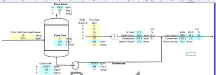

Dear All,
I have a process problem that I am trying solve. The Condensate from one side of the plant is sent to Flash Tank, flash steam separated by venting to atmosphere and the LP condensate is pumped to DN 50 (2"NPS) Condensate Header that has Condensate Flash Steam. The question is will the 2" Condensate header be overloaded resulting in high back pressure. This being done per Client's need who has asked as to check the feasibility. The input is provided below.
HP Condensate from Plant = 2534 kg/hr
Pressure upstream of Steam Traps = 10 bar(g)
Flash Tank Operating Pressure = 0 bar(g)
Condensate Header size = DN 50
Condensate Header Pressure = 0 bar(g)
Condensate Load = 254 kg/hr
Pressure upstream of Steam Traps = 12 bar(g)
My calculations are shown attached in the spreadsheet. The methodology I used (which I want to cross-check with you) is as follows:
1. Determine the % Flash in the 2" Condensate based on pressure reduction from, 12 bar(g) to 0 bar(g)
2. Estimate the Flash Steam Flow Rate and estimate the Flash Steam Velocity.
3. Estimate the % volume of Flash Steam and Condensate in the 2" pipe using the specific volumes of Flash Steam and Condensate.
4. Add the Condensate from Flash Tank and determine the new volume % of Flash Steam and Condensate.
5. Estimate the increase in the Condensate Liquid level and thereby estimate the reduced cross-sectional flow area for Flash Steam and thus the new Steam Velocity.
6. Check if this new steam velocity is still less than 15-20 m/sec recommended Flash Steam velocity in condensate return lines.
Your comments and resources will be helpful.

Your calcs so far cannot predict if the steam traps will be overloaded with high backpressure - calc stops at velocity estimate. Two phase flow pressure calcs can be complicated and risky especially in lines with risers. The calcs say that sizing case pressure downstream of existing steam traps is zero barg. Hence, if there are vertical risers in this 2phase condensate return line, it is very likely that this 2inch line is slugging some or all of the time, creating excessive backpressure on these existing IDOP traps.
See if there is ample excess capacity in each of these steam traps to deal with the backpressure induced at each trap from a 100% liquid full vertical riser ( line rising up to main pipe rack ? ) on this existing 2inch line going back to the central condensate collection drum ( de aerator ?). Do you have an overall piping isometric of this 2inch return header from these traps leading to central condensate collection ?
Assuming the condensate pump and trap discharges will ultimately discharge to an atmospheric tank, what is the pipe length downstream of the trap till the tank? The pressure drop in 2 phase flow may be significant
In your calculations you have assumed zero slip between the flash steam and the condensate flowing in the 2" pipe. It will not be like that. The condensate will flow at a slower velocity than the steam. Also, the condensate does not flow in a nice neat discrete layer at the bottom of the pipe. The steam will whip up the condensate and try to accelerate it and this is what makes the two phase pressure drop much higher than either of the two phases flowing alone.
The load, both in terms of flash steam and of condensate, is much higher for the 10 bar system than for the 12 bar system. Diverting the line after the 12 bar steam trap(s) into the flash vessel will not add much to the load on the flash vessel but it would mean that the pumped condensate would be liquid only and will give a velocity of around 0.3 m/s (1 ft/s) in a 2" line which should be OK unless the condensate line is extremely long.
It's incorrect to assume the pressure at the team trap outlet or the condensate return header is zero unless it's open to atmosphere. And, it won't work to connect the pumped condensate line to the steam trap header which may block the steam trap or cause water hammer in the actual operation.

Hi George,
Yes there is 15 m riser after the steam traps in IDOM area, so the traps would have to sized for the back pressure of 1.5 bar(g) at then minimum. The steam from the steam mains comes down by 15m to the heat exchange equipment and the condensate from these traps goes through the riser to reach the 2" condensate return header. Yeah so there is 15m riser that the traps need to overcome the static head for. Lets say the traps have enough capacity ( we do not really know yet as the project is in Basic Engineering phase). Agree the condensate will have to be flashed to 1.5 bar(g) pressure instead of 0 bar(g) as I previously did. But this condensate will flash further once it reaches the 2" condensate return header where the pressure is close to o bar(g). You are right the condensate and flash steam will have to push condensate slugs after it reaches the 2" header. For this reason the trap discharge lines and the common condensate header have to be sized for bigger size correct?. I donot have the overall isometric of the 2" condensate header. I will provide more updates as I get them.
Hi katmar,
Agree with you fully. I am yet to know the reason why they want to push the pumped condensate into the 2" Condensate return line which will already encounter significant pressure drop due to two phase flow. I also did not understand why would any one want the Condensate to Flash in the Deaerator. It is better to separate the Flash Steam in a Flash Tank, condense the steam using a Vent Condenser and pump it along with the LP condensate back to the Deaerator in liquid form. There is a meeting with the client tomorrow and I will update you more.

Please ignore the quoted post. The header at 15 m needs to be pressurized to about 1.5 bar(a)(by a downstream CV) to prevent flashing. This increases the back pressure of traps. Trap supplier needs to confirm adequate flow at back pressure of about 2.5 bar(g), which may be possible with some trap suppliers.

Actually, the velocity will increase as the flow experiences pressure drop due to friction, which increases the amount of flash steam. Additionally, there is likely to be a critical(sonic) flow at the header exit.
There is an update from the client. They have decided not to connect the pumped condensate to the 2" Condensate header as they also think that there will too much back pressure on the traps to prevent them from delivering as per their capacities. Also they are sending the Condensate from the 2" header t a flash vessel flashing off the steam and will be pumping the condensate to the Deaerator separately.
