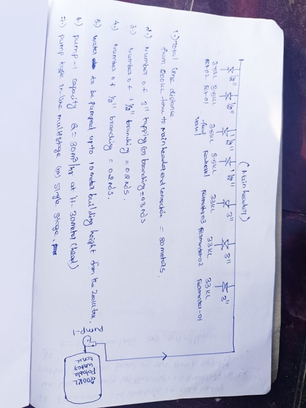

Thank you for your comments. We plan to route potable water to our block where we installed 33kl fermenters and we select pump capacity for 30 m3/hr with 30mtr pump head. The problem is I don't know how much header size would be efficient to fill up the fermenters fast. I have attached my hand sketch for clarity. All of your time is precious so when you have time consider my post again thank you all.
 https://files.engineering.com/getfile.aspx?folder=1e47febe-b9ce-412a-9c72-3525006e3a56&file=IMG_20240221_164841.jpg
Shvet tha line MOC is SS304 (ASTM A312).
Pump capacity is calculated by our managing director but he didn't tell us the header size.
Good liquid fluid velocities are between 1 and 3 m/s.
So always start with trying to selecting a pipe diameter that gives a fluid velocity of 2m/s
30m3/hr = 0.0083 m3/sec
Pipe area of a 2" diameter pipe = 0.002 m2
Velocity = 0.0083/0.002 = 4.15 m/s
That's a bit fast, so try a 75mm diameter
Assume a 75mm diameter and
Pipe area = 0.0045m2
Velocity = 0.0083/ 0.0045 = 1.8 m/s.
That is greater than 1 and less than 3m/s, so
Check your pressure drop of that 75mm pipe with an 8 liters/s flow.
0.47 bar per 100m length.
You have 80m so 0.47barg x 80/100 = about 0.4 bars of friction loss
= about 0.47 x 10 = about 5m head and
10m lost to elevation
15m total head loss.
Head remaining at end of line is 30 m pump - 15m friction and elevation leaves 15m at EOL.
Probably OK, since the flow will not be 8l/s through the whole 80m length.
15m head is about 1.5 barg.
Is that enough pressure at the last fitting?
1503-44 1.5barg pressure is enough for our filling requirements because we need just filling process we are not using any heat transfer like that.

I just edited the above to include the Web site pressure drop calculation results. Please review.
Note that I used roughness factor for steel pipe. Plastic pipe is much smaller at about 0.01mm.

Sounds like that could be OK. Recalculate the end of line pressure. 1 barg of remaining pressure may not be enough in some circumstances.
Another important point is to keep velocities under control. Any velocity through the smaller attaching pipes of 4 to 5 m/s could easily create the pipe banging water hammer noises. Everybody gets upset when those happen, day or night.

So what is normal maximum operating pressure in the fermenters / feed vessels ? Any control valves / throttle valves at the inlet to each of these ? It couldnt be just an uncontrolled open line into these vessels ?
Guys. Start a new thread.
Or not.
georgeverghese you are correct. There is one control valve right now I don't know about the details of them but the fermenter jacket inlet size is 1 1/2" (3 inlets on the jacket same as 3 outlets) as you know the fermenter is 33kl. We have connected the 3 inlets nozzle with common manifold of 3" size. I am handling the utility side piping like main headers and sub headers to the fermenter and rest of the internal piping upto vessel is providing by contractors. I will give you normal operating pressure and control valve details after I collect from the contractors. Thank you sir
