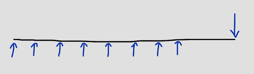

You have lots of supports at each of the overhangs from the rafters that are cantilevered along that wall. Obviously some of the values of these reaction vectors will be negative...

material doesn't matter (at least not until you start detail and selecting sizes). Cantilever your overhangs wherever you can. You'll have the primary framing direction - that's easy. extend the rafters out to form the overhang. in the other direction, come in whatever distance you need and turn framing toward that wall and cantilever those to form the overhang in that direction. Then use the rims in each direction to cantilever off of the overhangs and meet at the ends.

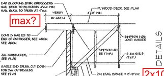

I feel like you're making this more complex than it needs be. Your drawing feels like a flat roof, but you get the idea, perhaps.
@lexpatrie The issue I'm running into there is the lack of space at the ceiling. I guess I could theoretically run them on top of the beams if I can get say 2x4's to work. Thanks for showing the detail it helps to visualize.
