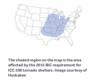

ASCE 7-22 is adding tornado considerations. IBC 2015 (18?) requires new schools and additions have tornado shelter included. Don't do work in tornado ally so not aware of standard practice, but I don't see the building code requiring shelters. A bit surprised by that. Any locals know what there are for tornado codes?
The challenge with tornados is still insufficient warning. I've seen too many times where the weatherman says, "Ok, we have a Tornado Warning for City XYZ." and by the time he gets those words out, the tornado is ripping things apart 15-20 miles downwind.
Thoughts and prayers for the victims and their families.
I found a discussion on the code issue authored by XL Catelin "When the Code Requires You to Design a Tornado Shelter"
ICC 500, ICC/NSSA Standard for the Design and Construction of Storm Shelters. The 2015 ICC building code requires storm shelters for a few occupancy in part of the country.
FEMA issues P-361 guideline on safe rooms, but does not mandate where safe rooms are required.
