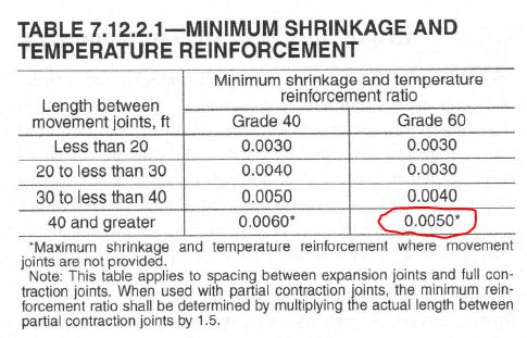

Hi i noticed a thread from a long while ago that several indicated that as long as the seawall had greater than 0.5% horizontal reinforcing that control joints were not required. Can anyone advise me on where that comes from in the ACI. I am working on a seawall project and would to obviously eliminate as many joint as possible. thanks
I do not remember this thread that you mentioned. Perhaps if you linked to it then we could all reference it. I am not aware of any code requirement for this purported 0.5% horizontal reinforcing.... but the theory is that enough horizontal reinforcing will keep any cracks tight so that they are not apparent. I'm not a big fan of this brute force approach to designing a seawall.
I have designed many seawalls (several different types) and I always put control joints in them. Are you worried about corrosion at the joint locations? That's easy. Stop all your horizontal reinforcing 3" short of the joint and dowel across @12" o.c. vert. with smooth GFRP bars that are 2'-0" long. I either use 1", 1-1/4", or 1-1/2" dia. GFRP depending on whether or not this seawall is located adjacent to a roadway as well. You don't need to worry about corrosion at the joint because your dowel is corrosion proof. There are several other things you should keep in mind such as increased clear covers elsewhere and really good specified marine concrete.
I think I know where that comes from....
ACI 350 has recommendations for control joint spacing, and a .005 is required when no joints are provided.

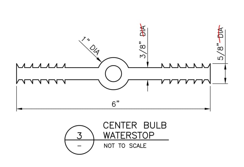

thanks i like that idea with the gfrp and holding the seel back. Yes corrosion is a concern. How have you done an expansion type joint that will minimize corrosion as well provide for adequate water tightness and minimize the sands/ fines in the back fill from coming through
PVC ribbed waterstops
I wonder if you could use FRP plates in one of the plate dowel systems. They go up to 3/4" thick plates.
cvg beat me to it. PVC ribbed waterstops with center bulb. Based on your anticipated expansion, size your joint filler appropriately within the joint.
Some people prefer to form a keyway with PVC waterstop at the expansion joint details but I am preferential to the smooth GFRP dowels. The only two things you need to ensure is that the location of the PVC waterstop and GFRP dowels don't conflict and that your dowels are installed orthogonal to the joint. I like to add some vertical GFRP runner bars each side of the dowel and each side of the joint to try and keep that dowel bar stationary during concrete pour.
strctpono - do you have a preference for waterstop length? is 6 inch adequate or do you recommend 9 inch? i have heard that the longer is easier for contractors to position correctly, but not sure I buy that.
You mentioned control joints. I don't think engineers use the terms control joint and contraction joint consistently. You need to define how much reinforcing is crossing the joint (if any), and what type of surface profile the joint has (if any). If there is a groove, then do you use poly sealant? Another maintenance item.
Center bulb WS is usually used at expansion joints, not control joints. Even with the best intentions PVC waterstops can fold over; only use 9" PVC WS at expansion joints. Better to use 6". At construction joints, of course no center bulb is used.

cvg, I also follow similar guidelines as ATSE. 9" waterstop with ribs and centerbulb for expansion joints and 6" waterstop with only ribs at control/contraction joints.

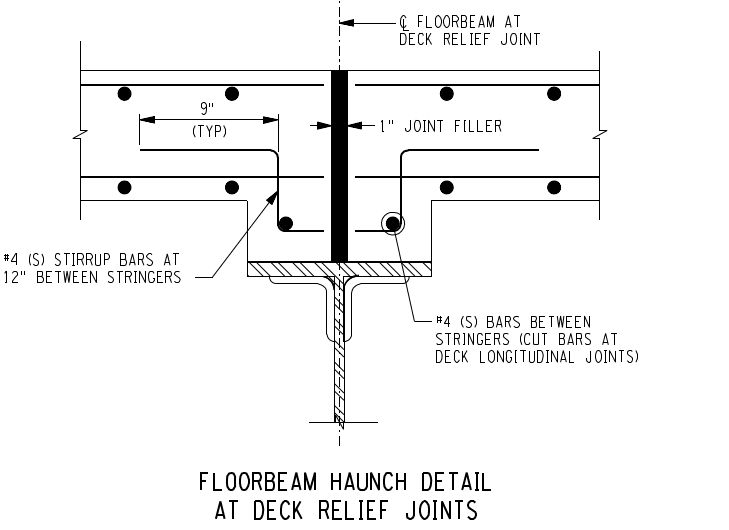

STrctPono - what do you mean by deflection joint? A few years back, I did a deck replacement on a mile long viaduct with crazy framing. One section had floorbeams with "deck relief joints". We mimicked what was done 80 years ago.
I was referring to your comment on joint in railings/parapets on bridges. We call those deflection joints. They contain a gap. No joint filler. Chamfered edges. No dowels or keyway.
Interesting detail on the deck joints. I've never seen that.
