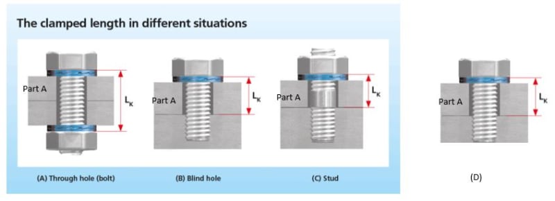

We have some product using through hole but not bolt and nut joint (#D). I would like to know if there is a standard to determine the thickness of Part A, the material being fastened?
Based on Nord-Lock, clamp length at least 3 times. Does it mean we have to use washer to compensate the clamp length if Part A is too thin?

I think "Lk" as shown only influences the stretch of the bolt ... not the strength of the installation.
I would ask Nord-Lock help desk. Are they giving you "turn of nut" or bolt stretch requirements for torque setting ??
I guess, your question is very valid in case there is a separation force between Part A and Part B (lover plate). You may be worrying about punching shear, adding washer will increase shear cross section and will be helpful. If the concern is shear (lateral) I think you need to check bearing and tearing on the thinnest plate in the connection as well as shear on the bolt.
Therefore the loading type is essential part of the discussion. You cannot get proper answer if you do not provide it in your post unfortunately. Perhaps a hand sketch might be helpful. Perhaps you will find your answer during the load sketching, you never know.
I have seen not only Nord-Lock suggesting the clamp length is 3 times of the bolt diameter. If the joint I use is (D), does it mean I have to use 3x dia for part A thickness? It seems too thick as I have seen this joint, like the picture below, in our product with thinner part A...

L/D of 3 is typical design "rule of thumb". Your sketch (from Linkedin) is IMHO misleading (or not helpful in your situation, shown in your post of 22nd).
I don't know of a limitation of the thickness of the clamped plate, Lk in d), other than bearing etc.

In your joint config D from 22 August, the thickness of part A has nothing to do with the pull out strength of the threaded part.
I have no idea what shear load you are referring to. Pull out strength is related to an axial load on the fastener.
