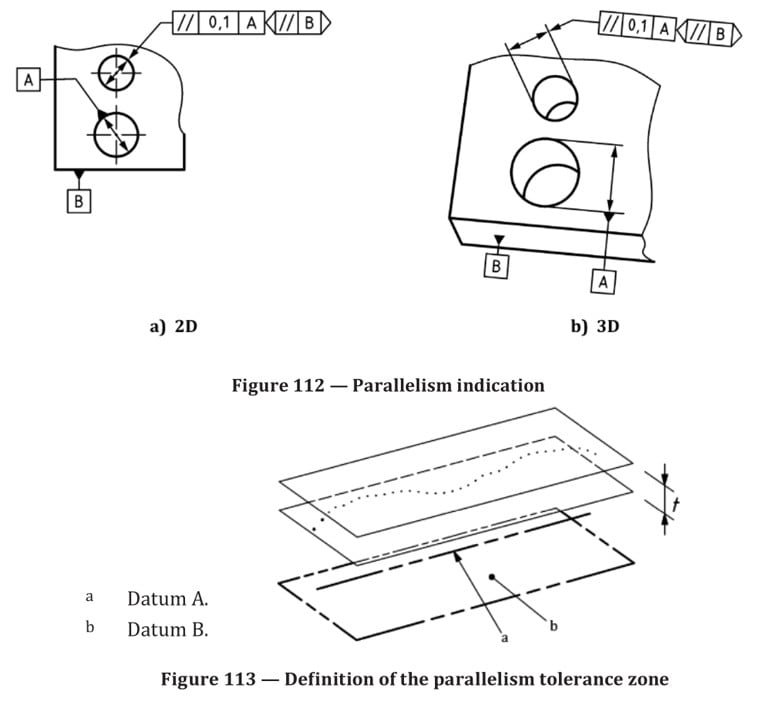

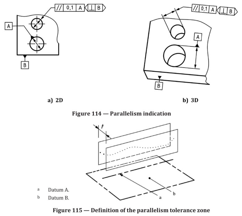

I'm trying to understand how previous editions of ISO 1101 specified the orientation of tolerance zones in the 2D case. Datum A indicates the center of the larger hole and both tolerance zones are parallel to it. Is B now the orientation plane? How does it constrain the tolerance zone further and where is this rule printed in ISO 1101:2012? For one zone it is parallel to B, for the other it's perpendicular so I guess the parallelism symbol only refers to A, not to B.
Edit: Also somewhere it is stated that the leader lines indicate the orientation of the tolerance zone. So there's no need for B here, I think.
Thanks.

The orientation of the measurement is controlled by the reference to B. In the first case that relationship is implied by the apparent perpendicularity or parallelism of the tolerance direction.
If B is not used then it isn't clear which direction the two measurements are to made. It might have been relative to the vertical side if B wasn't mentioned.

Thanks 3DDave, the figure is indeed from section 8 and reading it doesn't clarify how it works for me. My confusion lies in how the relationship is implied. I will expand a bit. I understand that the parallelism symbol relates the tolerance zone orientation to datum A. I think the parallelism symbol does NOT relate the tolerance zone orientation to datum B because otherwise one of the two specifications would be incorrect. Besides, how can we know which zone should be parallel to the horizontal and which zone should be parallel to the vertical?
You say the relationship is implied, what I'm not seeing is how it is implied.
If B was not used the direction would be clear from the leader lines, no?

Suppose that the vertical direction was meant to be measured parallel to the side surface and the horizontal direction was supposed to be measured parallel to the bottom surface. By including the datum reference it is clear which surface is the one that orients the measurement. Without it you could not be sure. Since it's not explicit in the callout for the first case it is implied by the orientation of the leaders.
Please note the arrow of the leader line gives the direction is a former practice in 2012 version, 2017 version specify the orientation plane indicator on both 2D and 3D print, here is the examples from the ISO 1101 2017 Standard.

Do you agree then that in the first case B is not used for the orientation of the tolerance zones wrt the work piece? This is what I was trying to figure out: How does B constrain the tolerance zone? Answer: It doesn't.

If B was not used in the first case, the two tolerance zones would still be allowed to freely rotate. Notice that regardless if they were at 0 and 90 degrees to the datum B (nominal condition) or at say 45 and 135 degrees to datum plane B, they would still remain parallel to datum axis A. This in turn would result in an infinite number of solutions, which would have to lead to a conclusion that the drawing specification was vague.
Therefore, a reference to B is needed to constrain that unwanted rotation of the tolerance zones.

Indeed there would be an infinite number of solutions (assuming the former practice of the leader lines is somehow insufficient). Then I ask, how does B specify the orientation of the tolerance zones? The one might be at 0 degrees and the other at 90. Or the one might be at 90 degrees and the other at 0. Where in ISO 1101:2012 is the rule that explains how this specification should be interpreted?
I understand the point about measurement. You should place the work piece on a surface plate or such before measurement. I don't understand how B specifies the orientation of the tolerance zones or if B does that at all. It cannot be the parallelism symbol or both tolerance zones would be horizontal and overlap which makes no sense.

Since B is referenced in tolerance frame, the orientation of the two-planes tolerance zone is at a TED angle to datum B. Generally, the orientation is either perpendicular, parallel, or set by a specified TED angle. The decision of whether it is parallel or perpendicular is according to the leader line direction. The tolerance zone is perpendicular to the leader line. This is indicated in para. 8.2 (page 13):
ISO 1101:2012(E) said:
In 2D view, when the direction of the width of a tolerance zone is at 0° or 90° relative to the datum or relative to the pattern of the theoretically exact dimensions without using an orientation plane, the arrow of the leader line gives this direction (Figures 22, 23 and 24). In other cases, an orientation plane shall be used
Figure 23 which you posted yourself and Figure 24 that shows the interpretation for the tolerance zone of fig. 23 indicate that it is perpendicular to the leader line.
