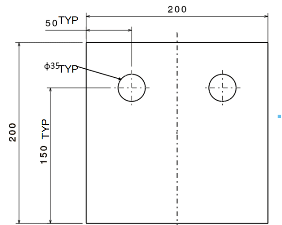

We received a drawing from a vendor...the drawing below is just for illustration of what I wanted to ask
I noticed the hole on the right is not dimensioned...he explained that since he has drawn a centreline in the middle (I forgot to dimension it), it automatically means that all dimensions to features on the left applies to the other side of centreline. I've not come across such a convention...I did some cursory check online and I am not able to find any references which say such a representation is allowed. I will go through ASME Y14.5 in detail but was hoping to get some opinions from experienced engineers.

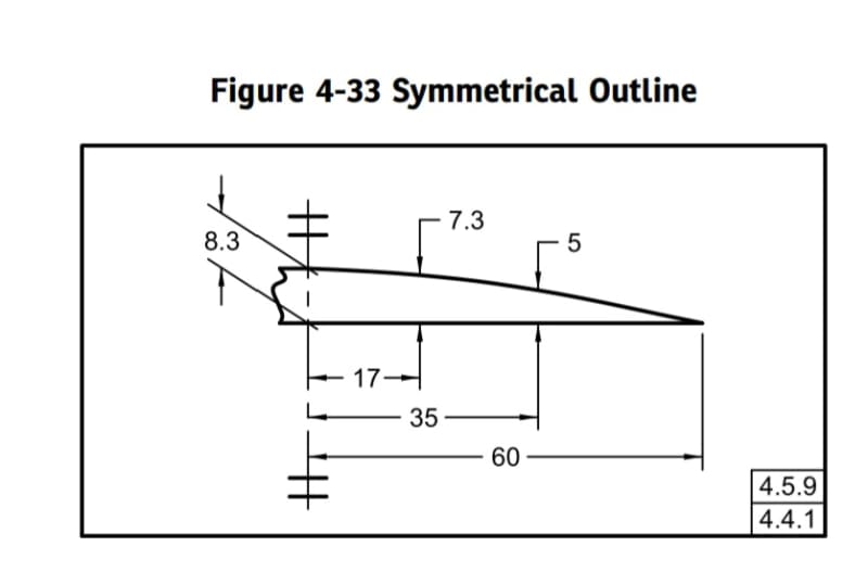

Within the practices covered by ASME Y14.5, there is a way to dimension half of a symmetric geometry and imply that the other side is mirroring the dimensioned features. But this is done differently than in the vendor's drawing - with specific symbology and only with half of the part shown, as in the following image:
Without using the above mentioned-method, adding "2X" before the relevant dimensions in the vendor's drawing would resolve the ambiguity.
^^Burunduk, I made an omission in my drawing. All the hole dimensions include TYP call-outs. So it seems like above method is indeed allowed within ASME regulations.
I added TYP texts in Powerpoint...thus the misalignment

VN1981,
The note TYP is not mentioned in ASME Y14.5.
In many cases the outer boundary of the part does nothing, except holding the matter in place. A 100 between the holes would be better most of the time (except when said plate is locating sg. on its longer face)
VN1981,
The drawing is crap, but I can interpret it.
If he applied tolerances, he probably see the folly of dimensioning symmetrical holes from the outside.
JHG
I agree with everyone above. TYP is not a standard notation, so it is ambiguous. I've worked with enough people that do this, and when they explain it the same way as the vendor. Since they explained the symmetry thing, just go with that. But refer to @drawoh in the first sentence for the complete summary.
