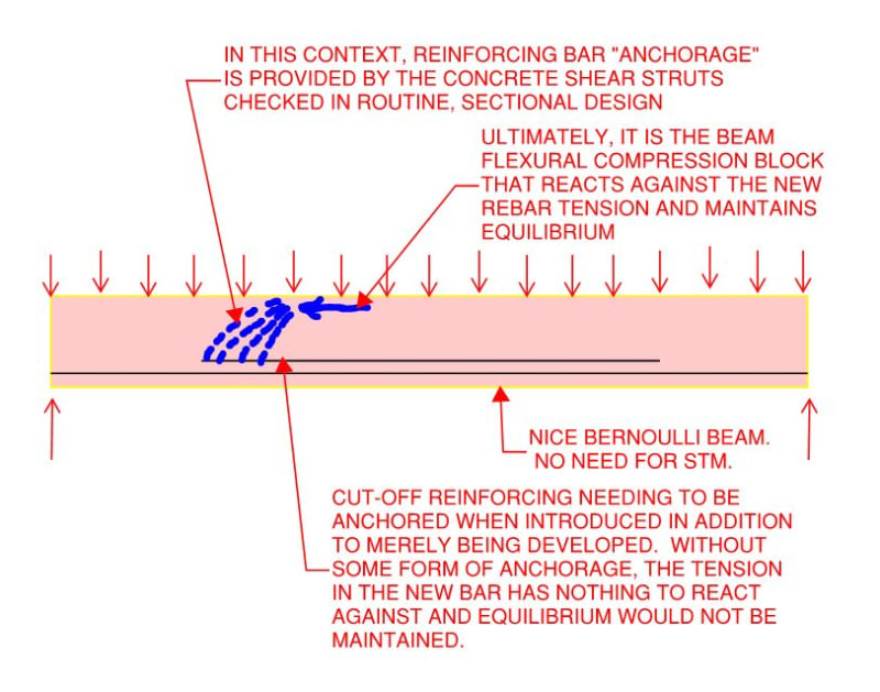

I don't understand sure what you're getting at here. Can you provide a sketch or a photo of the failure mode that you're envisioning? In a code compliant lap splice, the failure should, by definition, be yielding of the spliced reinforcing bars. If that's not the case, then the world's got a rather serious problem on its hands. Conversely, from a practical design perspective, do we care how non-compliant lap splices fail?
Thanks a lot for your drawing and explanation, KootK, but now I really don't understand how you calculate the "anchorage length".
A quick thought: maybe you call "development length" to what we call "basic anchorage length" (which depends on just the concrete strength, the steel yield strength, the diameter of the rebar, and the position of the rebar at the time concrete is cast).
...and then maybe your "anchorage length" is what we call "design anchorage length" (which depends on the basic anchorage length, as well as the actual stress of the rebar and the anchorage procedure: straight, bend, hook, loop, welded transverse bar,...). Obviously, our "design anchorage length" is always less or equal than the "basic anchorage length".
If your difference from the "development length" to the "anchorage length" has nothing to do with any of this, then I really don't understand how can you consider in your "anchorage length" formulas the phenomena you are describing without using a strut-tie model.
But, anyway, in your first post you seemed to say that development and anchorage were interchangeably used in North America in the past... so... maybe there was a change in the theory models at some time? When did it happen? Can you point me to a book which you would consider as the key document that clearly defined the difference?
1) If it's reinforcing anchored by concrete in tension (3b above) then it's the Eligenhausen anchorage stuff often referred to as "Appendix D" in North America.
2) If it's reinforcing anchored by a concrete strut or compression field (3a above), then the anchorage checks are really built into the normal checks for shear and flexure and additional checking to verify anchorage is not required.
Feel free to post a sketch of a situation in which you're not sure how to satisfy the anchorage requirement and I'll do my best to show you how it's done.

The sketch below shows just such an example and how it is dealt with without resorting to strut and tie. Effectively, adequate shear and flexure design in that case provides the necessary anchorage capacity. Of course, our provisions for shear design when using stirrups is really utilizing a strut and tie truss model so, in that sense, it is still related to strut and tie.
No change. The requirement for reinforcing steel to be anchored by something, most often concrete compression struts/fields, has been a requirement of reinforced concrete design since it's inception. I think that the confusion comes about because:
1) Authors consider this requirement to be so fundamental to concrete design methodology that it doesn't warrant being stated explicitly.
2) Because type 3a anchorage is satisfied indirectly via conventional shear an moment checks, designers don't realize that these checks are, in part, addressing the anchorage requirement.
