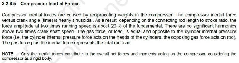

Hello everyone.
I have the natural frequencies of the piping system of a reciprocating pumping unit, I need to verify the separation margin indicated in Annex C of the API 674 standard.
If I have a triplex pump that rotates at 300 rpm, the significant frequency would be f=3*300/60=15 (Hz) as indicated by the standard, but I don't understand how to add inertial loads and how are determined.
I hope you can help me, thank you very much in advance.

From the quoted standard it doesn't sound like you need to add them, only to determine what the frequencies are and ensure a separation margin from them (the "plus" seems is more like a logic term than a mathematical addition).
Inertial load is load associated with accelerating a mass (F = m*a). Arguably not a true force but it acts like one in many ways.
For that machine I'd say inertial loads are at 1x running speed. Each rod/piston provides an inertial load at 1x running speed. Three rods give three sets of forces spaced at 120 degrees in space and time, which cancels some of the inertial forces but not all (for example the moments created by the forces acting at different points along the crankshaft, or where there are slight differences among the three sets of moving parts).
Many forces can have multiples of the fundamental force frequency created if they are periodic but non-sinusoidal (think Fourier series). I think the pressure and stretching forces fall in that category but to my thinking it wouldn't apply to the inertial forces in this situation. That actually seems problematic for the pressure and stretching forces... if you are allowing for harmonics based on non-sinusoidal behavior, how do you bound them to ensure they are 20% below the resonant frequency. That seems more involved to me.
TLDR to my thinking all you have to worry about for inertial is 1x turning speed for this configuration but the pressure and stretching forces might include harmonics of 1x turning speed (i.e. 2x, 3x etc)

electricpete, what you assume is correct, the pump is similar as show in the link.
As for the inertial loads, it is as you mentioned, these are a function of the equivalent reciprocating mass, ratio of crank radius an connecting rod length, the crank rotation angle and the angular velocity.
The formula I found to calculate this force is:
Fs=ms*r*ω^2(cos Ɵ+λ*cos 2 Ɵ)
where: ms is the equivalent reciprocating mass, λ is the ratio of the crank radius and connecting rod length, θ is the crank rotation angle and ω is the angular velocity.
and the section of the API 688 code that mentions that the amplitude of the inertial load at 2xRPM is approximately 20% of the fundamental.
However, I have not been able to find more information to help me determine that frequency due to extra inertial loads or to justify that this addition mentioned in API 674 is not necessary in this case.
