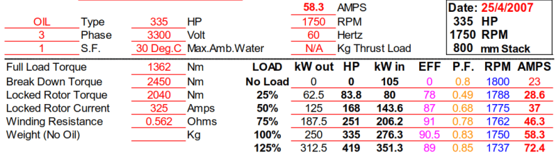

Dear All,
I have a confusion here. I have a working system like this,
Electrical motor:
RPM: 1500 @50Hz
Full load torque: 1651
Power: 250kW
Hyd pump:
Model: Eaton PVWS 360M (variable displacement)
flow: 360cc
Power consumption: 315kW @ 350Bar
Driving torque: 2005 @ 350Bar
above pump will drive a hydraulic motor below:
Hydraulic motor:
Model: Rextroth A6V (variable displacement)
displacement: 355cc
Max Torque: 1978 Nm
Max Speed: 2950RPM
So, our operating pressure is 220 Bar.
lpm @ 220 Bar of hydraulic pump = cc/rev x RPM / 1000 = 540lpm
@540lpm, the hydraulic motor will deliver 1344Nm and 2525RPM
When I calculate the hydraulic motor power base on this calculation they gave in their catalogue,
Power = 2 x 3.142 x T x RPM / 60,000 = 646HP = 482kW.

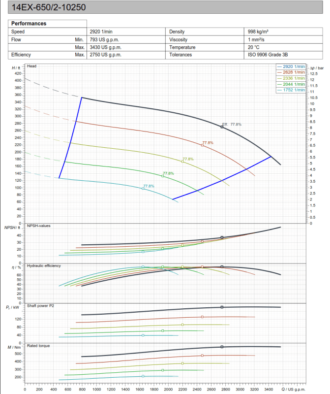

This Hydraulic motor is driving a submersible 3 stages water pump with following spec:
Head: 171m
speed: 2920 rpm
(see attachment for detail)
My question is, can that be possible? Hydraulic motor power is 482kW but the electrical motor is only 250kW? Sorry if I sound stupid, but that is a working system from a manufacturer which I can't trace them anymore. Or did I make false assumption some where?
TIA.
R.Efendy

It's a common mistake to assume maximum flow and pressure simultaneously on a centrifugal pump. You posted the pump curves. What do they tell you about your operating point.
I suspect what the manufacturer did was start at the end user (the submersible pump) and work backwards.
So I suggest you do the same. Find out the actual flow and head required and then translate that back to a speed and power from your pump graph.
So yes, the electric motor is the weak link in the system if you wanted to increase flow or head. Quite why they used such oversized hydraulic units isn't clear but that's what it looks like from here. [tt][/tt]
Good morning,
The error is that the motor speed is 360/355*1500RPM=1521RPM
Thank you all, I got what you all mean.
R.Efendy
found my mistake, I used wrong units and water pump and hydraulic motor info were wrong.

Electrical motor:
RPM: 1500 @50Hz, 1800 @60Hz
Full load torque Nm: 1651 @50Hz, 1362 @60Hz
Power: 250kW

Water Pump Spec:
R.Efendy
