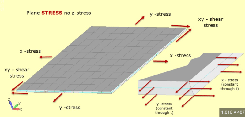

Hi everyone, I have been working on NASTRAN for a few months and I have a problem that I would like to bring to your attention. I'm working on a model composed by shell elements and want to obtain the planar stress (in the xy plane of the elements) of some GRIDPOINT that I've specified in a SET. The problem is that I don't know how to manage the STRESS card in the BDF file in order to output what I specified above. I specify that I would like to obtain a numerical output (in the f06 file) and not just a graphical output on the post-processor. Thanks in advance

what is "planar stress" ? "normal stress" ?

yes, I'm looking for the y and x components, and I say planar stress because these components lie on the xy plane.

these are normally called "normal stresses" (at least for the direct x- and y- stress), or in-plane stress, or in the case of a 2D element (like a CQUAD) ... stresses.
