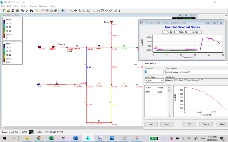

Thanks for various inputs, anyway this is something I screenshot another system, I just downloaded recently and still not able to figure out the parameter like node:
Anyway the time series is something like this of another system.
It has calculated the pump curve using regression analysis between runs at different flow rates, just like you can do with Excel. Plot the points and select "show equation on chart".
OR maybe the user has entered the equation for the pump.
What exactly can you not figure out? What parameter?

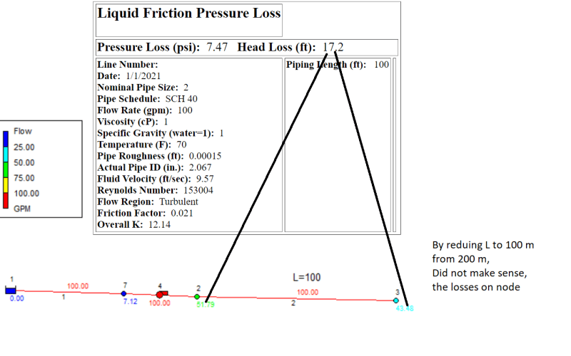

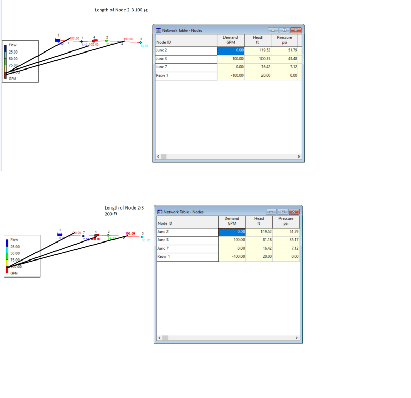

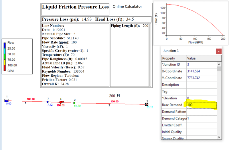

Hi 1503-44,
Thanks, I have simplified my Hydraulic as below
Epanet System 100 GPM in 200 Feet 2 in length.
Case 1
I set Node 3 to have 100 GPM, not sure if this how it works, so in other words, the curve of the pump is redundant as it may run as constant flow of the 100 GPM Flow into node 2 and 3.
Some Doubts.
1. Why the node 2 is having 51.79 Ft and 35.17 Ft on node 3.
2. From the online calculator along the 200 Feet is having close to 34.5 Ft. It is close to Node 3, however, shall node 3 be close to 0 as it is exit ?
3. Not sure why node 2 is 51.79, can you help me understand this ?
Case 2 (Reducing the Pipe Length from pump to exit to 100 Feet)
1. Why the node 2 is having 51.79 Ft and 43.48 Ft on node 3.
2. From Online calculator along 100 Feet is correctly 17.2 Feet losses.
Just curious, is this the limit of Epanet, they are not able to determine the Head and flow based on the PC curve

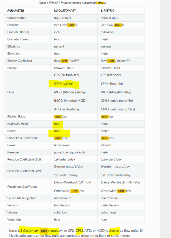

Unit US GPM, By default it is feet. The text is user input was corrected and not data input.

Hi Red us the flowrate
100 GPM
Node 2 to 3 is the only length .
All pipe is having 2 inch
Node 7 to 2 is just a pump node.
1 to 7 is 10 ft length

I think you should only set a supply to the system at node 1 of 100gpm and a demand from the system at node 3 of 100gpm.
One thing for certain is that the program has been used millions of times over many years now and does not appear to have significant errors, so first suspect GIGO and throughly check that input files and data is precise and fully correct.
1503-44,
The supply is 100 GPM is node 3, downstream is set on 100 GPM which I did.
Somehow the pressure on node, did not make sense. Please refer to screenshots of comparison below
100 Feet VS 200 Feet in 2 Inch Pipe
My epanet file also attached below
** The text was typo unit, however the epanet software is in US unit, length was in feet.
bmw,
You are confusing metres with feet all the time and also psi with head.
So in your post on 1st jan the figures in green and turqoise are psi, but you appear to be comparing them to ft head. So they won't compare.
In the post above this makes sense to me.
For 100ft of pipe at 100 gpm you have a head loss of about 19 ft
For 200 ft (not m) at 100 gpm you have a head loss of about 38 ft.
So double the distance, double the head loss at the same flowrate. What is confusing about that?
