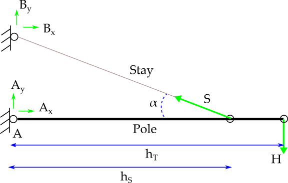

A pole can be modelled in one of two ways—being free to move at the base (like a hinge) or being fixed at the base.
Hinged Pole
Figure 1 is a free body diagram of a pole with one stay and a tipload (equivalent load applied at pole tip). The pole is modelled as hinged at ground level.

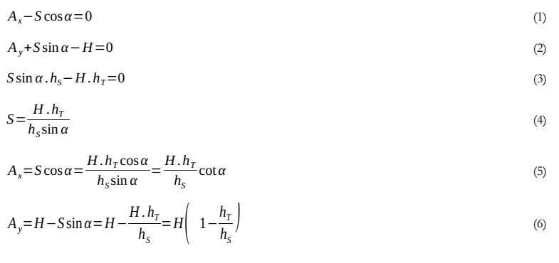

The system is in static equilibrium so the equations that apply are
Equation 3, the bending moment at the pole base, equals zero by definition; the pole is free to rotate about the base. All horizontal resistance is provided by the stay and equation 4 shows that the tipload H is transferred in full on to the stay, increased by factors due to attachment heights and the angle of the stay.
The compressive load in the pole is Ax (eqn 5) and tension in the stay wire is given by equation 4.
These observations show the quotation above would be valid if the pole is modelled as hinged.

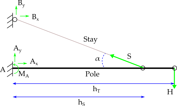

Fixed Pole

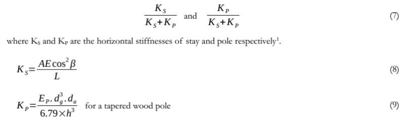

Similar to figure 1, figure 2 is the free body diagram for a pole modelled as fixed at the base. The load is distributed between pole and stay according to the ratios
A cross-sectional area of stay
E modulus of elasticity of stay
L length of stay wire
β angle between ground and stay = 90 - α
EP modulus of elasticity of pole
dg groundline diameter of pole
da tip diameter of pole
h pole height above ground

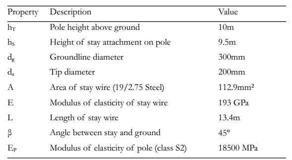

Looking at some realistic values:
KS = 8.13 x 105 N/m = 813 kN/m
KP = 1.47 x 104 N/m = 14.7 kN/m
Equation 7 shows that the stay carries 813 / (813+14.7) = 98% of the transverse load. In reality, because of ground movement and creep, the stay could be considered as carrying all the load. KP is directly proportional to EP and KS is directly proportional to E so even for a combination of the least flexible timber and the weakest cable the stay will still carry the majority of the transverse load.
Our brief exercise shows the quotation above is also valid if the pole is modelled as fixed at the base.
