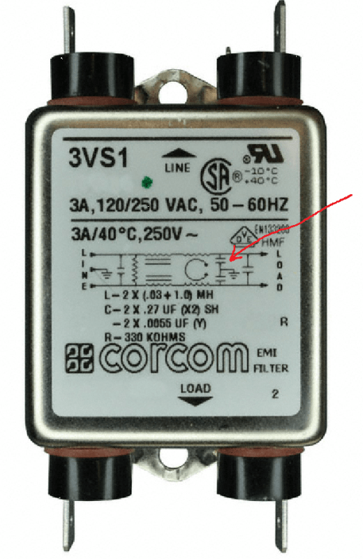

Switching supplies in a quest to remain within conducted noise limits often have front-end filters. Lots of them include capacitors to the chassis.
I had a new S-100 computer that had one of those "metal box" filters with the four leads directly hooked to the IEC computer power-cord receptacle and a fifth grounding lug tying it to the chassis. I used it to run AutoCad 4 in DOS, of course. (yeah, yeah, I date myself) One day I wore shorts and my knee bumped the 19" 6U case edge. I was jolted so hard I swept my keyboard off the desk. My office mate looked at me inquiringly. Smug bast*rd had a new Kaypro. Anyway, troubleshooting I found that the cord failed to connect the ground to the chassis and that the filter was leaking badly to the chassis making it... lively.
The point of the story is that frequently I find supplies that will trip GFIs. Lots of VFDs will do it too. If your system has filters, a leaky supply, or several supplies that wouldn't individually trip a GFI but en-mass their individual filters could be adding up to your GFI tripping.
