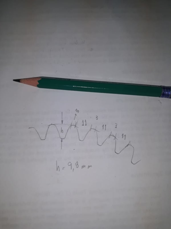

Hello,
I need to make 3 new helical gear pinions with the same type of teeth of the attached picture (sample gears)
How can I calculate the outside diameter D for each of the new pinions. Z1=20 , Z2=22 and Z3=24
I have measured the outside diameter of the 2 sample gears:
Z=40 , outside diameter= 173,5 mm
Z=25 , outside diameter= 111 mm
