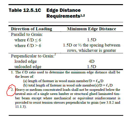

This seems to come up on these forums every couple months. NDS has a reference that says not to load below the neutral axis, see image below.
American Institute of Timber Construction has a document that discusses wood connection detailing. APA has as similar document that also discusses connection detailing.
The construction of the LVL seems it would be less susceptible to issues with this arrangement. The footnote doesn't mention this for structural composite lumber.

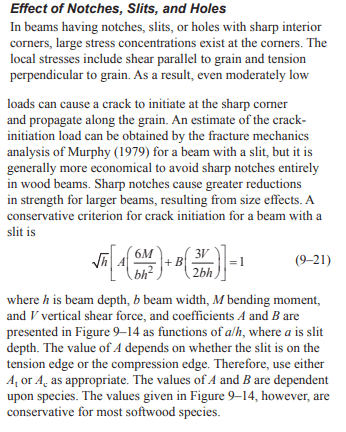

Interesting questions, Is the code unclear? NDS calls it out quite clearly in chapter 3.
Chapter 8 of NDS limits tension side notches at bearing to 1/10 of member depth on structural composite lumber. In addition to shear checks, this limit is also to reduce potential for cross grain tension failure at notch corners, the wood handbook from forest products laboratory teases this idea out as well.
LVL is manufactured in such a way as to basically ensure that all the grain is oriented in the same direction, and that grain is also oriented in the axial direction of the member. We do not have the advantage of slope of grain that causes an angular adjustment to the tension perp vector that you might expect to see with sawn lumber and glulam.
I think the table is unclear, and most of NDS discussion about perpendicular tension is rather unclear as well.
What is a heavy load? medium load?
Does placing the bolt above the beam cl really preclude perpendicular grain tension?
The ESR report from the manufacturer fails to mention anything about this.

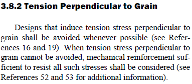

So we are left with the table provided in Ch 12, and the paragraph (on tension members) in chapter 3. Which calls out sawn lumber and GLB specifically.
So what is the answer to the OP question, is 90# hanger load below the centerline of the LVL a heavy load or medium load? If its neither of these then there shouldn't be any issue according to the code. Except the nebulous text in 3.8.2 that says avoid wherever possible and reinforce if needed. Is that for heavy loads & medium loads, or all loads?
