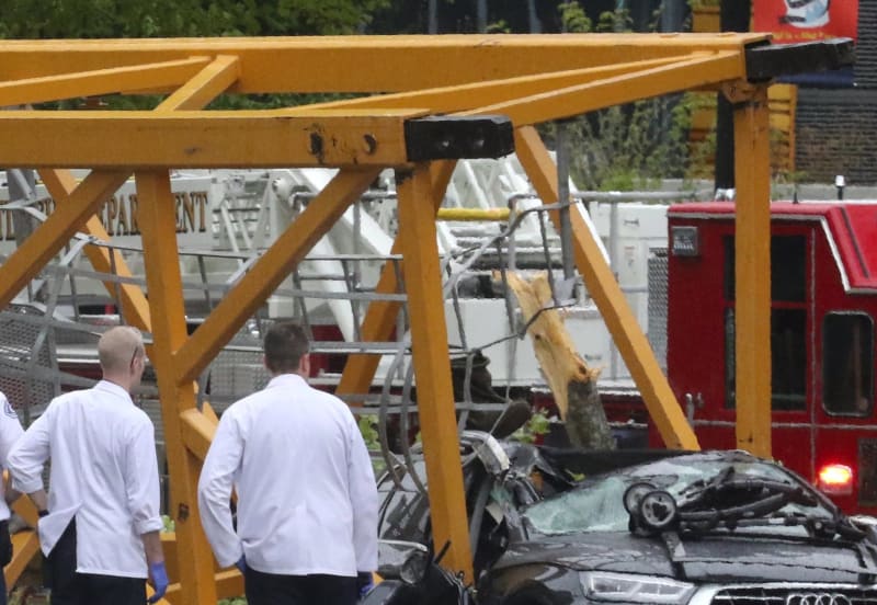

I'm currently looking into a pinned connection design for a modular truss. Think similar to a tower crane but smaller. Does anybody have any experience or references that I need to look at? Strength design isn't a challenge, I'm more after designing appropriate tolerances for firm fitting while still maintaining easy errection and dissasembly.
(Photo from a Seattle tower crane that collapsed, because they removed the pins. Surprisingly hard to find photos of these pinned connections online!)
Eurocode tells you how to design pin connection
Is the modular truss 3D ? In case of tubular structure, you can use the same concept like tower cranes.. You may use solid rectangular insert elements. In past, I designed Warren type roof truss with rectangular hollow sections and each truss was two pieces for easy transport. I used end plates with small brackets (similar to column base plates ). The connections was with preloaded high tension bolts.
