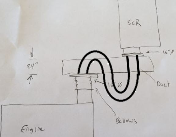

I have an upcoming project that requires an offset in some 16 inch pipe but don't have room for two 90° elbows. I believe this can be achieved using rectangular ducting but there are complications of very high vibration and rapid temperature cycling of up to 1000°F within minutes. What type of engineer specializes in this type of design? This one is way over my head. I don't know where to look.

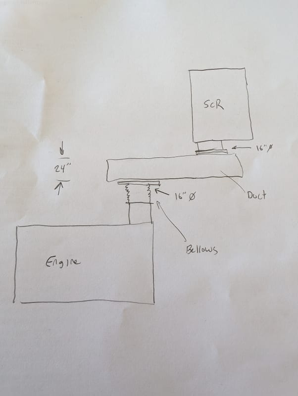

It's a diesel engine exhaust. I have 2 vertical pipes that are offset by 48 inches. I need to connect the two pipes but have only 24 inches of vertical space to do it. The pipe diameter is 16 inches. Flow velocity in the 16 inch pipe is in the neighborhood of 9000-10000 feet per minute. Pressure ~1 psi.

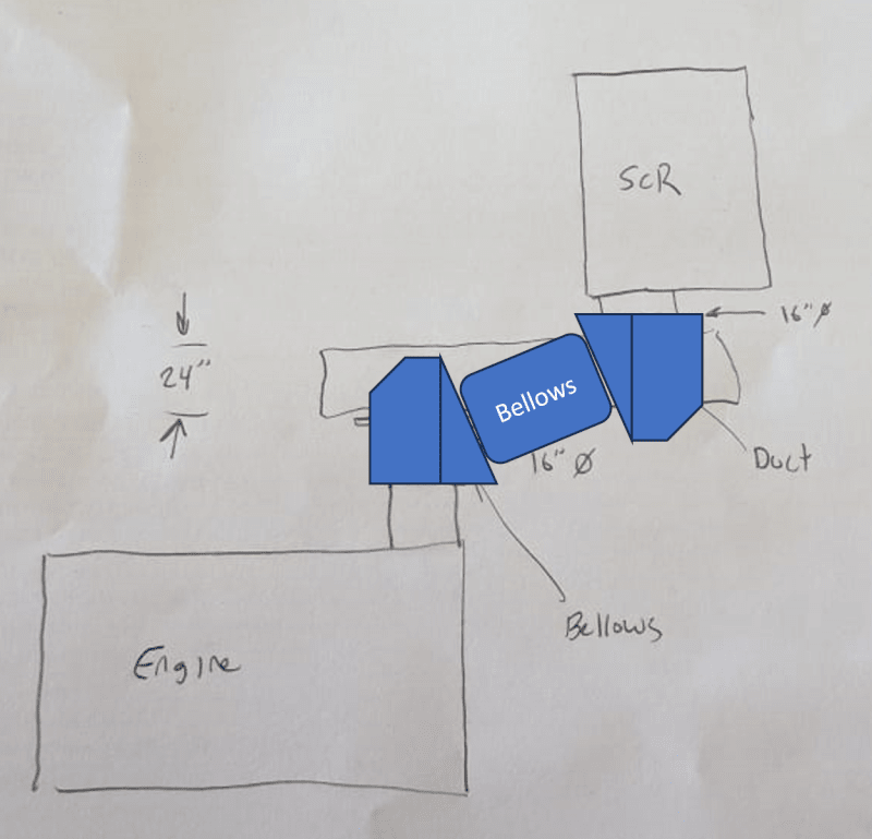

16 inch elbows are 24 inches tall. If I use two elbows to make my offset I would already be at 48 inches. I am thinking of building a box with offset 16 inch inlet and outlet but I not only need to estimate pressure drop but also design to resist cracking due to vibration and extreme temperature variations.

The driveline dictated the engine height. Visibility and clearance issues dictate the stack height. We're already doing the steel work to raise the stacks as high as practical.
I understand the bellows situation is not ideal, we have worked out a solution with our supplier that has been successful for years in service.

I used an item very much like your sketch to connect my dryer vent up. I suspect it doesn't come in a 16" size!
it seems like two 180 bends or four 90 s.r. bends would do the job if you swing the elbows to keep your 48" spacing, i.e., don't go there in a straight line.
The first two bends are already 48 inches long. I don't have room for the next two. I have to do a straight line.
Do short radius bends exist in 16 inch? Don't they cause a lot of back pressure? Are they expensive or have lead times to purchase?

I think a CFD package could do most of this; doing the transient response is going to be difficult and the vibration is into the multi-physics arena; maybe a COMSOL consultant.
With that immediate sharp turn this is practically dead-heading about half the flow into a pressure rise and then the pressure re-accelerates the flow only to be neatly partially dead-headed at the next sharp turn, with another pressure rise.
Turning vanes into a rectangular section would help with that, but a conversation with Hastelloy may be needed to get vanes and an impingement surface that last.
Perhaps moving the bellows farther downstream, past the pressure rise and the highest temp would be a help.
