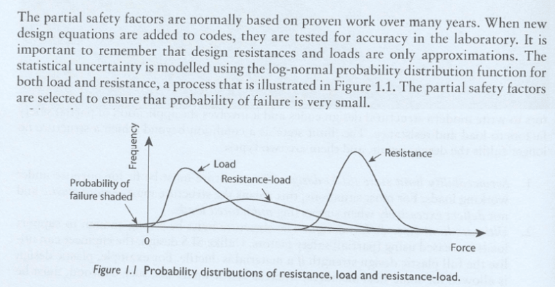

What is the purpose of using the word 'partial' with safety factors? Is it because different factors are applied to different types of load and materials.
Refer to the attached figure. Can someone please explain this graph to me? What is resistance-load and how was the probability of failure determined?
Best regards,
Su
 https://files.engineering.com/getfile.aspx?folder=a636da64-46be-408e-acaf-07c81184b37a&file=Extract_from_Design_from_first_principles.PNG
I have copied and pasted the attached figure ;
This is the graph of Resistance - Load (Resistance minus load ) function which is by definition , the performance function (g)...The use of the same graph is misleading..There should be a seperate graph for ( Resistance - Load ) curve with; X axis is probability ,vs Y axis Recurrence..

R is the resistance and design resistance Rd = Rk/γm and Ed is design value of effect of actions Ed ≤ Rd
In short , R is the resistance and E the effect of actions
g = R – E and probability of failure Pf = Prob(g ≤ 0)
