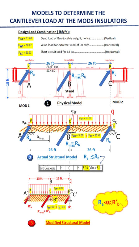

We need your help to help with an internal discussion among the electrical discipline to estimate the loads on a rigid bus with two spans with the uniform load as shown in the sketch below. This is a model that can be idealized as a beam with a uniform distributed load (Deadweight, wind, and short circuit)
Someone is trying to calculate the end reaction using a modified model reducing the span in half and following the recommendation on the IEEE Std 605 for a beam uniformed loaded. We are a little skeptical about questioning this method but do not have enough structural background to reject or accept this simplified suggested approach.
Can any structural colleague provide some advice on this matter?

Are you treating the spans as simple span? What are your supporting beams? Regular rolled sections? Curious mimes want to know...
I cannot tell what the things at the ends of the span are, or the slightly sloped elements in the middle. [ponder]
The suggested method is against simple equilibrium rule of statics .
If the busbar is continuous ,
(q*L)
Ra =Rc = 3/8(q*L) (L is span length = 26 ft) and Rb=2*5/8(q*L) =5/4(q*L)
If If the busbar is not continuous , two simple span,
Ra =Rc = 1/2(q*L) (L is span length = 26 ft) and Rb=(q*L)
Regarding the recommendation on the IEEE Std 605 , can you pls post some excerpt ? will help to see the concept..
I have IEE Std 605-2008. You are right to question this person's method. From my reading of the Standard (Paragraph 12.1.4 "Continuous Bus"), the "Modified Structural Model" shown is wrong. We can get into "why", if needed. Does not matter anyway, the insulator-support system shown is vertical.
Per Paragraph 12.3 "Simplified Evaluation of Insulator Cantilever Force", only wind and short circuit loading are considered (dead load and cable weight are not relevant).
Therefore, "Actual Structural Model" shown is basically right... but it needs to be "tipped over" 90 degrees to represent loading from only wind plus short circuit.
Solve for R1, R2 and R3, the insulator cantilever force:
