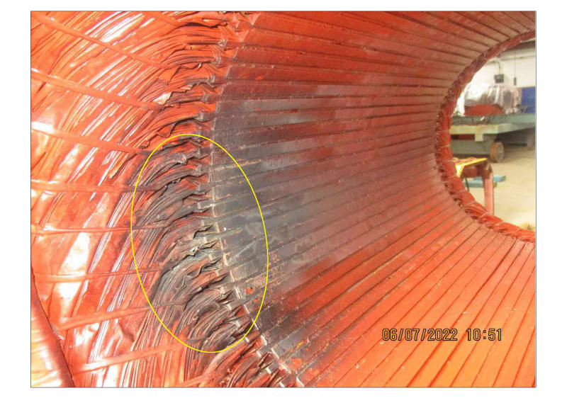

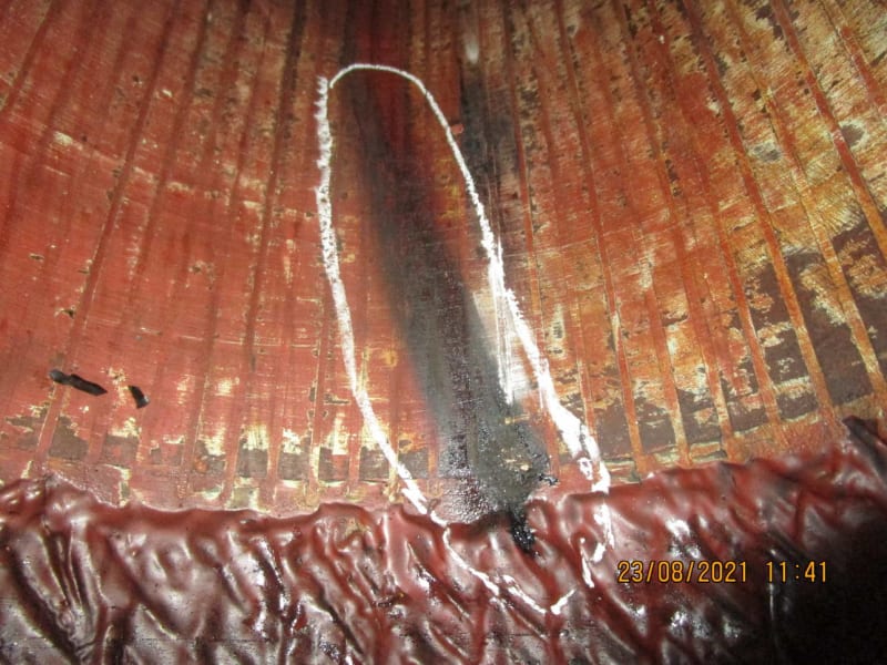

Winding failure photos

The photos are not clear evidence of it being an issue from voltage pulse damage to the windings. It might be, or it might be something else. Looking at the EASA winding damage photos it tracks as a possible voltage surge OR contaminants, vibration etc. Given the environment and what appears to be signs of corrosion, I might suspect the salt air as a possible culprit.

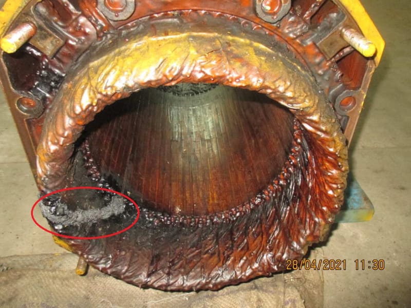

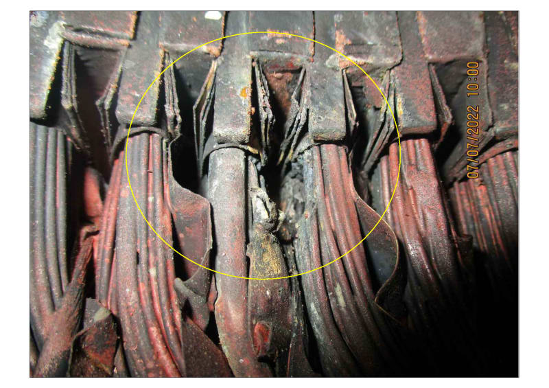

Below are a few OEM VPI winding failures which indicate high voltage resulting in turn to turn faults and ground faults. They failed at 3 different client off-shore rigs.
I will tell my clients to install dv/dt filters to protect their motors and my warranty.
