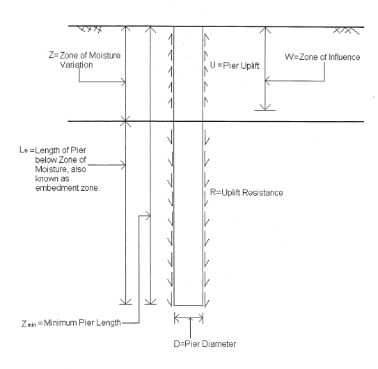

Dik - It appears these piers will likely see large uplift forces due to swelling soils. The piers should be fully reinforced.

With uplift, they should have reinforcing full length, but it can be a single bar.

It's uplift force from the skin friction on the pier. When expansive soil and/or bedrock is exposed to moisture it will swell around the pier which applies an uplift force on the pier. Piers should be drilled past zone of moisture variation into moisture-stable soil or bedrock, therefore there will be zero uplift force on the bottom or sides of the pier in the moisture-stable soil/bedrock. The geotechnical resistance from uplift is developed from the portion of the pier anchored into the moisture-stable soil or bedrock.
Here's a figure from the attached CAGE paper "Commentary on Geotechnical Pracices - Drilled Pier Design for Lightly Loaded Structures in the Denver Metropolitan Area".
