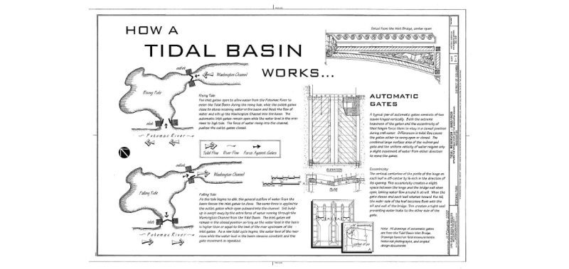

Are there any techniques to self dredge. It would be good if it can be automated.
I'd suggest how, but haven't a clue, They use a dredge often, but I think it's rented almost yearly, and takes months to clear the silt. Been doing that at least since I arrived in 1982. This is why they should only elect engineers to political office. So self-serving I know, but not proven wrong, yet.
Maybe water could be used to push the silt out of the way. That would be a salt water pump, and tubing at the harbor inlet bottom, to constantly move silt outward.
Just guessing of course. I'm Electrical Engineer, and this isn't an electrical problem.
Just asking for curiosity, but I will forward suggestions to people who should listen, but likely won't.
Kevin
I am not sure if this is a useful answer, but this is exactly how the tidal basin in DC works.
Hains Point is named for the US Army Corps of Engineers' Peter Conover Hains, the engineer who designed the Tidal Basin.
