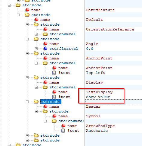

Does anyone know how to change the ANSI drafting standard settings to get my Datum callouts to look correct?
Currently the Datum has a dash before and after the letter. I just want the letter in the square (no dashes), with a triangular base.
Please see the attached picture. (CATIA V5)
 https://files.engineering.com/getfile.aspx?folder=9a703dba-178c-4ae0-be86-5404609a70c4&file=DATUMS.JPG
Try digging down into your drafting standard xml file and see if it reads "-show value-". then try deleting the -'s.
2021-01-13_12_59_51-XML_Notepad_-_L__CAD_CATIA_260350_win_b64_resources_standard_drafting_ASME.xml_c2sjx8.png
thanks Lucus!
I tried using the Standards Editing tool, but couldn't find anything on Datum features.
I'll follow your suggestion and see what's in the xml file.
I checked both ANSI and ASME xml files and found both had the same settings:
-<std:node name="Display">
<std:enumval name="TextDisplay">Show value</std:enumval>
I didn't see any options for choosing what type of datum style to use
Any other ideas?
I believe you need to be in admin mode for the editor to function. There's a thread in the forums on how enable that. But to me, this is the correct spot to start looking (standard/xml file)
