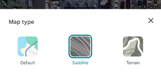

Is anybody else disappointed in the deteriorating satellite image quality of Google Maps?
Hmm?
That's what they say. Ever actually pondered any of that imagery? If, for instance, the images are from satellites rather than vastly lower airplanes, why do the images of power poles tip soooooo far away from the base? Those images are from a few thousand feet at most. Certainly well below any "low earth" satellite. So, go ahead and sue google, good luck, or just accept that they exaggerate a bit...
Because that has nothing do do with things. If you aren't taking photos from directly in line with the vertical axis then you are going to get that effect whether it is from a satellite or a airplane.
Lol. Have you heard a telephoto lens?
Oh yeah I remember that time when North Korea allowed Google to do almost yearly 'flights' with their aircraft barely a few thousand feet over Pyongyang:
(Yes, some areas can have higher resolution images provided from aircraft. But Google Earth which has been incorporated into google maps is primarily satellite images.)
Because the satellite probably was not directly overhead; earth observation satellites (EoS) don't always have good lines of sight for observations.
Nevertheless, there are also aircraft based collections
From Google Earth; https://support.google.com/earth/answer/6327779?hl=en
How images are collected​
You can see a large collection of imagery in Google Earth, including satellite, aerial, 3D, and Street View images. Images are collected over time from providers and platforms. Images aren't in real time, so you won't see live changes.
When images are collected​
  • Some images list a single acquisition date, which is defined by the image provider.
  • If an image is a mosaic of multiple satellite or aerial photos taken over days or months, a date range with a start date and an end date is displayed to show the dates the images were collected between.
  • If little or no date information is supplied by the data provider, a start and end date are shown for the range within which we can be reasonably certain the image was taken.

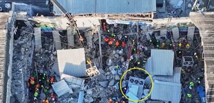

A problem with broadly spaced roof beam systems is lack of redundancy with respect to point loads. It appears that the main a/c unit caused the roof beam to fail, though lack of stability in the perimeter support may have played a significant role. The remainder of the beams appear to have tipped over towards the initiation point.
Edit: The main a/c unit appears different than the one captured in Google Maps imagery here so equipment upgrades could be a factor or vibration from failing units may have caused unaddressed issues. There is also mention of a fire in 2023 (though I've lost the reference)
No obvious external indications of this problem from Jan 2019, at least not at this resolution, though the roof diaphragm clearly flashes through the perimeter finish at the north and south ends of the stage wall.

There's a wide array of image sources and image qualities in Google Earth. Yes, there is undoubtedly a base of satellite imagery, but given the wide variety of sources and image quality it seems there's also a variety of elevations and focal lengths involved. If the image angle of power poles remained relatively constant as one moved along the line that would suggest a large distance between the camera and the surface, but when that angle changes noticeably over relatively short distances it certainly suggests a shorter distance between the camera and the surface. Having an image set that covers just a metropolitan area with higher resolution than the surrounding areas certainly suggests a special aerial imaging effort. That one such image set can have lots of different shadow angles also suggests a longer period of image collection than the pass of a satellite.

This e-house type unit looks like something rather heavy for the roof.

The rooftop and streetside infrastructure have been significantly upgraded since Google Street View canvased the area in January 2019 (or even August 2019, here). Note the new roof mounted transformer (225KVA from CBC here) and adjacent sidewalk utility pole (from metro.co.uk)

From the many photos available on the web, the lighting system for the show on the evening of the collapse was standard fare. I've come to believe that lighting and sound equipment is much lighter than in the 60's/70's but the building wasn't designed for its modern day usage. It won't be difficult for authorities to scrutinize the as-built concrete beams. I haven't seen photos of any broken sections yet.
A quick guess from Google Maps says the room is roughly 60ft x 120ft. Google AI suggests a room that size should be capable of holding 750 occupants in its format as a night club.
