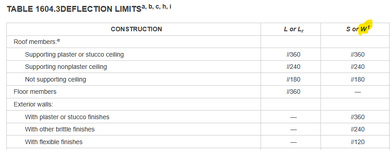

In the residential world it's pretty common to get lovely things such as a house on the side of a hill facing an ocean
These sites get the lovely combo of both higher wind loads due to the ocean/terrain combined with regular/reliable winds i.e. a higher frequency of windy days than inland sites
These types of houses also inevtiably have lovely architectural features such as 4m cantilever floating roofs (definitely not basing this on a real job...)
For such features, the cantilever tip deflection is a critical consideration - the client doesn't want to see a permanent sag, and they don't want to sit inside and watch it flop around in a wind
So we design to a serviceability condition that is based on a 1/25 year wind - say L/150 or L/300 maybe
For our 4m cantilever that still equates to a tip deflection of 15-25mm which I think would be a bit displeasing to watch - but hey, it's only 1/25 years, right?
Enter the 1/1 year wind - under our code, the 1/1 wind is 63% of the loading of the 1/25 year wind
So you'll be getting ~10-20mm of tip deflection occurring once a year (and you can keep reducing that fraction for more frequent winds again)
To me, even 10mm of deflection occuring ever year feels like it could be enough to get a displeased owner ringing you up for an explanation - they do say it's serviceability issues get you sued, not ultimate issues, after all...
Is a 1/25 year wind actually the right metric to be considering? Maybe, as I'm not aware of issues in reality?
