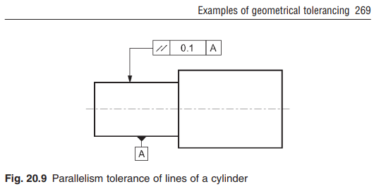

Does the Parallelism or the Straightness get subtracted from the minimum diameter to establish the virtual condition of the illustrated cylinder? The envelope principle is not specified / invoked in this case.
Attachment should be the same as inline image, for those who can view the inline image.
