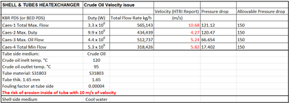

The real case as below. This thermal design is done by client (user).

That table is going to need some explain as nothing seems to make sense.
E.g. case1 and 3 are similar mass flow yet 3 is half the velocity??
But velocities appear to be unreasonably high and don't seem to make a lot of sense but we only have 5% of the information.
Is this a case of someone just getting some numbers from a program or spreadsheet and not putting brain into gear?

The table is from HTRI reports for evey cases.
Regardign the high velocity, if vibration is not an issue at the high speed, then the service/design life of the S31803 tube at the high speeds (erosion) may only be the concern point. Am I right?
Agreed, running at 11m/sec on tubeside with 22Cr std duplex would be acceptable only if crude oil has no erosion corrosion potential
One things that needs attention with high velocities (other than vibration and erosion) is the inlet and outlet erosion issues.
And this HX will be very noisy.
It might be from HTRI, but it still didn't make sense. Mass flow rate bear no relationship to velocity
