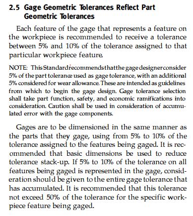

Regarding the 10%, this is a common target (at least in automotive) for keeping gauging errors below the range of that which is being measured.
Doug,
Sorry to probe it further, but this one is of my pet peeve. Based on what document you are saying that -- in automotive in particular-- the 10% is the rule ?
I agree with you but I cannot find a document to show just that ("Regarding the 10%, this is a common target (at least in automotive) for keeping gauging errors below the range of that which is being measured.")
Greenimi,
Here's the relevant section from ASME Y14.43 regarding gauge tolerances:
Mech1595,
I am not sure the automotive adopted Y14.43.
Are you sure about that?
From GM standard

Greenimi,
Unfortunately, I don't have a document in hand or mind that defines this. Your reference from GM, along with Mech1595's ASME Y14.43 reference, communicate the 10% guidance. I know that Ford and Chrysler generally use the same guidance, and in discussions in which I've participated no one ever asked for a source, because everyone agreed. Are you encountering parties that question the 10%?
Doug,
Yes, I am.
Gage suppliers who pretend that can give / sell us everything. Like 50%- 80% even 100% of the part tolerances.
They are basing their arguments per this statement
"b.) All fixture details such as check pins and bushings, details used for electronic measuring devices, etc. which check part features are to be located within +/- 0.10 mm."
What that means?
Means that all parts should have tolerances over 2mm to be within ±0.1mm.
So I am questioning the validity of the tolerances from my above post
Your GM Standard citation looks like it might be generally covering things like body panels. I would think that for precision features invoking part 3 would be pretty obvious. I think they are mis-applying part 2.b. On what types of parts are you working, and what is your specific role? Even if ASME Y14.43 isn't universally accepted in automotive, you could still possibly get your Designers to cite it on the drawings, or just add a simple clause that "fixture tolerances are to be maximum 10% of the associated part tolerance being measured".
Best regards,
Doug Hunter
