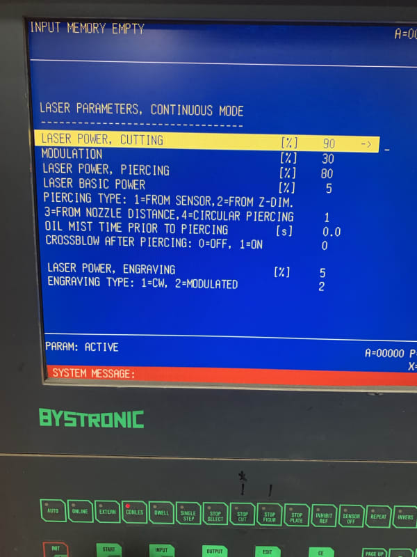

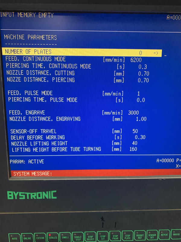

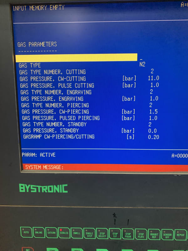

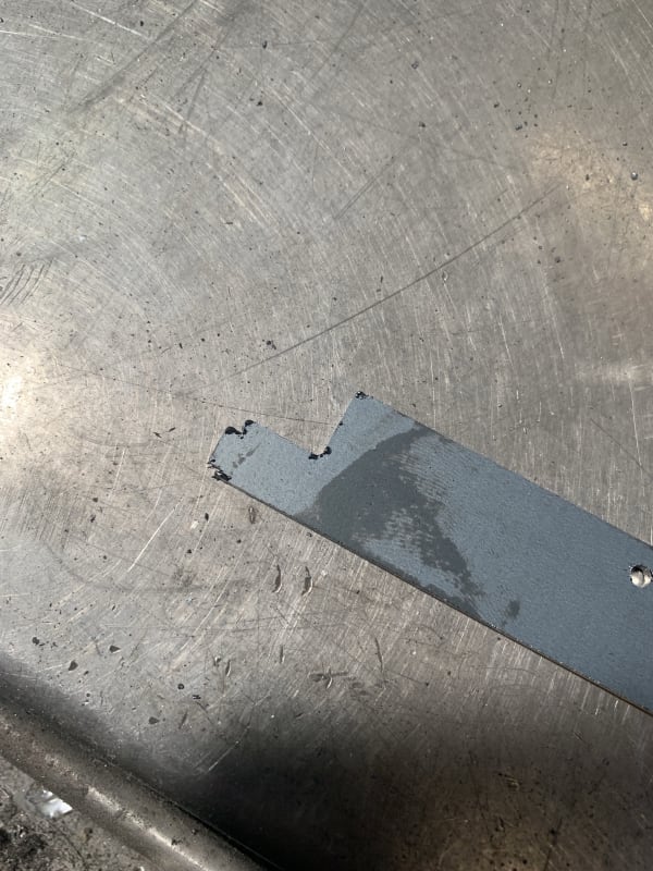

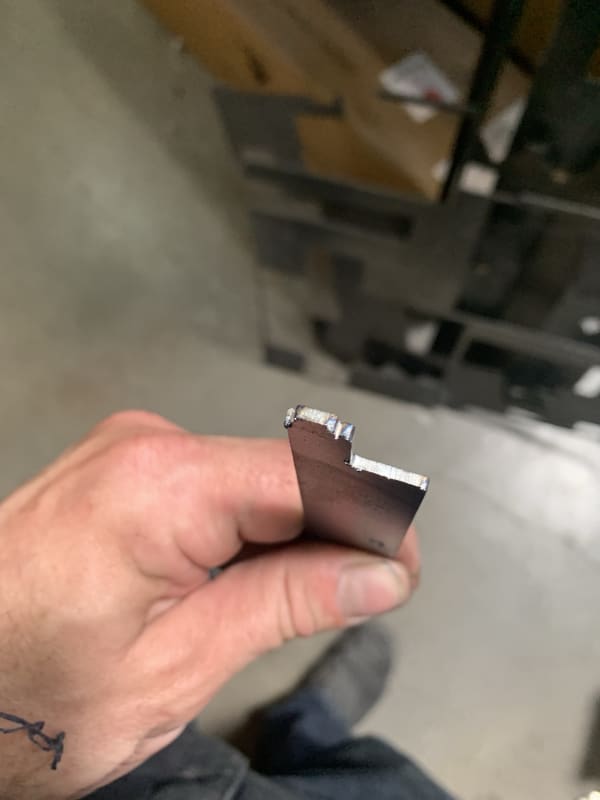

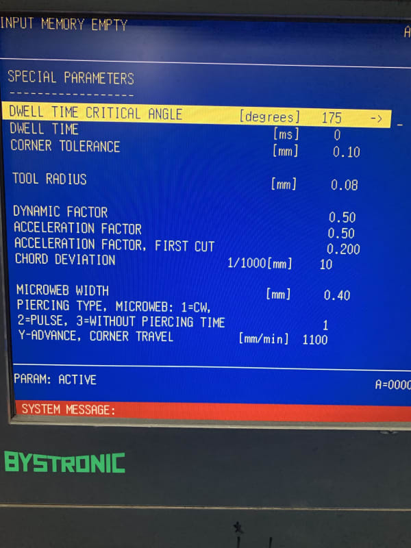

Hi guys I need help when I cut mild steel with nitrogen I get a small drop on corner, I really don’t know on what setting should I play with, my hole are nice and straight head cut are good. Another thing it’s only happen with 14 gauge and 11 gauge
Thank you
picture of my issue and my parameter

sorry for the late response. most likely you have too much heat and not enough speed in the corners. crank up the modulation and play w the dwell
