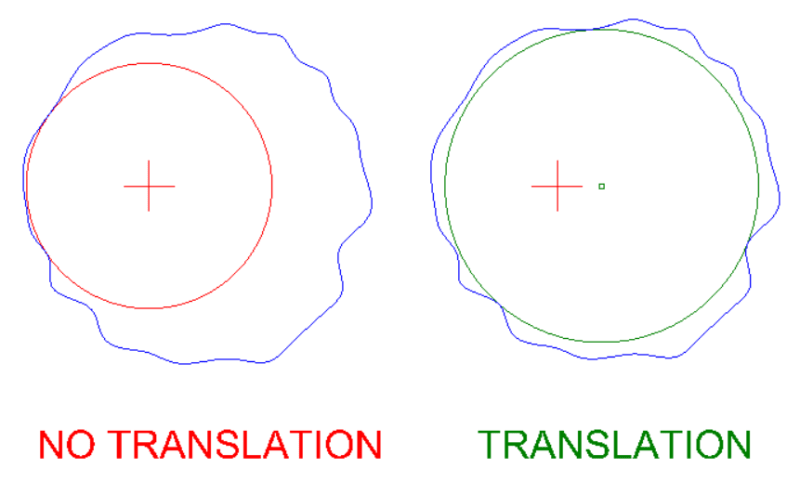

Without the translation modifier, the simulator contacts the datum feature in a way that isn't very good for constraining the clocking rotation.

There are two justifications for specifying the translation modifier.
The minor one, in my opinion, is for preventing measurement repeatability issues that may be caused by the very partial contact between the clocking datum feature and simulator. The partial contact may compensate the ability of the datum feature and simulator to apply the rotational constraint. This explanation is also provided in the following Tec-Ease tip, posted by sendithard in the beginning of the related thread:
May 2010 tip of the month
What I consider as the major justification for the use of the translation modifier, is when it better represents the functional constraints acting on the component at its actual working conditions. An example for this is the functional constraints and assembly fits that I described in the post that started this thread. There is no functional support for the requirement of basic location for a datum feature simulator of a press-fit hole, intended for accepting a pin that mates with a slot. A movable datum feature simulator will align the part to the DRF and the tolerance zones in the functionally representative way.
Personally I think that for the vast majority of cases with similar geometries and constraints, the schemes that make sense are either MMB for the clocking datum reference (when the mating component's location in the mechanism is fixed), or RMB with the translation modifier, for press fit, or may be threaded holes used for clocking
