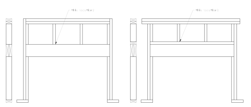

Does a cripple stud-to-header connection require a 'bottom' plate? I've seen openings framed with and without a plate between the header and the cripple studs, but have not had an intelligent conversation as to why. Can anyone help with that?

A bottom plate can be nailed down into the stud whereas a header would have to be toe-nailed. So it is easier to construct with a bottom plate. Structurally, it is not required.

If the drawing on the left below is what you are referring to, I do not know of any requirement that keeps you from attaching it directly to the header. the only time I have seen an upper cripple nailed to a sill as shown on the right is when the header itself was capped top and bottom with a sill to make it deeper and stronger, not to provide a sill plate for cripple nailing.
I like the plate because I feel as though it acts as an effective girt to resist wind pressure. It's been getting increasingly difficult to claim that the beam itself is the girt given that:
1) Energy codes are pushing us towards lintels much narrower than the walls that encase them and;
2) I learned on this forum that composite action in built up members fastened with dowels is pretty much BS, no matter what the pretty pictures in our mechanics of materials textbooks showed.
For similar reasons, I actually get more concerned about not having a plate under the headers.
Until 1.75" LVLs came along where 2 layers were the full thickness of our 3.5" wide wall, we always capped top and bottom to tie the layers together so wind was resisted by 2 layers, not 1 and to keep the layers from "wandering side to side". I have not capped any LVLs yet but do require them to be "lightly" screwed to each other. I still cap dimension lumber. If I do not cap them, I require 1/2" plywood between the layers and then they are lightly fastened together.
I have not been faced with the energy issues yet but am pretty sure it is on the horizon. I have not had many problem with built-up members acting as a composite but I have rarely had one that "pushed any boundaries".
