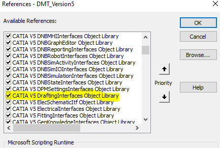

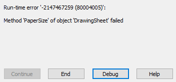

Create New Drawing Document
Jegsaran
Automotive
Dec 16, 2020
42
Hello,
I'm trying to create a new drawing document using CATIA.Documents.Add("Drawing")
Post creation the sheet format and sizes are empty as shown.
I tried the following but it is throwing err in papersize line. Is there any other way?
Code:
Dim drawingDocument1  as DrawingDocument
Dim drawingSheets1 as DrawingSheets
Dim drawingSheet1  as DrawingSheet
Set drawingDocument1 = CATIA.Documents.Add("Drawing")
Set drawingSheets1 = drawingDocument1.Sheets
Set drawingSheet1 = drawingSheets1.Item(1)
drawingSheet1.PaperSize = catPaperA0
tried your code and it works... catPaperA4 works also
regards,
LWolf
Oh! For me it is throwing the following error
check if you have that library in your references... (Tools-References)
if you use CATIA VBA-editor, right click on the paperSize line, and look at the definition:
Library DRAFTINGITF
C:\Program Files\Dassault Systemes\B28\win_b64\code\bin\DraftingTypeLib.tlb
CATIA V5 DraftingInterfaces Object Library
regards,
LWolf
