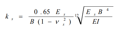

Perhaps you can get the elastic modulus from the PMT and then calculate the Ks using Ks= Es / B* (1-v^2) in F/L^3 units. See Bowles book equation 9-6a.

Okiryu has provided a simplification of the original Vesic interpretation presented in Bowles. The full formula is provided in the image below where Bowles simplifies a twelfth root and 0.65 to be equivalent to 1.
