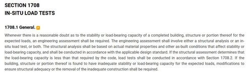

Also, this Loading History, I'm going to have to go off on that idea as well. Because a structure has stood for 100 years is NO evidence that it's experienced a design level event (especially in a seismic zone, this entire premise is totally refuted by California's 1986 URM law and subsequent mandatory reinforcing/retrofit projects).
If the existing is constructed wrong, or defectively, that is the exact opposite of reality, particularly when it comes to a stability-induced failure, i.e. lots of things are stable when they have zero load on them besides their self-weight, up here in the North, older roofs that don't "math out" on the design side probably never saw design level snow because the air leakage and the heat flow through the under-insulated ceiling melts the snow so it never reaches a design level event. Hypothetically in a region where snow load minimums apply, maybe, as those loads are intended to "cover" a one-time extreme snow event, i.e. minimal opportunity for melting or no melting, then maybe, but where snow loads represent an accumulation over a season, NO WAY.
Imagine if you "designed" a multi-story deck this way. It's never seen the design loading that's why it hasn't collapsed yet. I'm sure most engineers at some point in their career have come across something they are a bit mystified it hasn't fallen down, regardless of how old it is, and yeah, if it's never seen the design loads, that's a potential argument, but to reverse it and say a) because it hasn't collapsed it HAS seen the design load, that's simply speculation (technically, I think this is a contrapositive statement). Maybe if you can find enough weather information, maybe. Provided it's a wind/snow issue that controls the design.

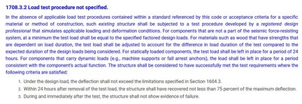

In general, I’m a big fan of load testing, and if it passed muster during a design event, I would trust that more than I would trying to analyze it using our simplified methods / tools. But if not, then a redesign (or at least reanalysis) it is.
This. But at the residential scale it's simply not practical (I think Algo center did load testing on their parking deck, for a large area).
Plus, given the fire, you have to half-a dollar sign dollar sign it and then test it. What happens when it collapses during load testing (as here in the States that's generally for more than 100% of the design load). This is much more of a rabbit hole that's never used, and it's "never" used for a reason, as you can actually destroy what you are testing to prove it's OKAY. That's "fine" for a component, so to speak, like a guardrail, as you're proving it was unsafe and gosh, darn, turns out it's unsafe, as it breaks free of the anchorage, oh well, (there's a longer story here, from personal experience, ask later), but for a roof, that's a partial collapse you are playing with, and it's hard to load it, too, when it's pitched.
Now, just to soften the tone slightly, a graphic..... 2015 International Building Code
