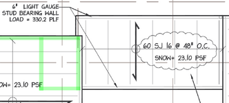

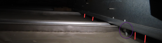

I'm trying to design a knee brace connection to this cold form joist that I can't really find any relevant information on. The section is two cold-formed channels measured to be 8" deep, spanning 13', and they are spaced 4' on center. The plans call out 60 SJ 16 with a design snow load of 23.1psf. The stud walls below them were designed for 330.2psf. With a 13' trib. width (6.5' going each way), the design load could be roughly 50psf. However, I don't really know if this is ASD or LRFD. See below for the picture and plans:
From my understanding of this section, this is a 16" GA, 6" deep channel (which doesn't match the field measurement). Since it is cold-formed steel, I feel this structure was economized and putting in a knee brace connection spanning to two of these 4' on center double C members is really not the best idea. Even if it was, I don't know what the best way to attach steel angle/HSS to a cold form channel. I'm leaning more towards putting in a second member spanning between the walls and not relying on the cold form floor joists. The only information I've found on this section is from an old USG manual...but it has to do with tall wall studs and not being used as floor joists.
Can anyone provide any design guidance for my situation or at least know where I can find a load table to get a feel for how these floor joists are performing in the original condition? Thanks for your help,

I'm not sure I follow. Here is what our drafter preliminarily came up with for this site:
This mount would be attaching in the bays of the 6" light gage studs spaced at 16" O.C. The kicker would come up to member that spans between the two Double C roof joists marked as "60 SJ 16" (discussed above) that are spaced at 4' O.C. We can go back into the field to try to get a measurement on the C channels but I was hoping for some sort of load table for this application but I wasn't able to find it.
I'm anticipating there being a significant amount of ice load on this mount, so if the joist was at 100% in the original condition, this type of connection may not be the best (as snow and ice are in the same load combination). We do have a precast floor below, so a lot of the load can go down there...but I need to have some sort of connection up top to help take out some of the lateral load as I was having issues with edge distances and this mount acting like a huge cantilever.
Maybe it would be better to have a strong 2x6 span in the web of this stud and reinforce the joist? I'm guessing that I should be able to to find a section to span this distance to argue we aren't weakening the original stud? I'm hoping to get some advice from someone that deals with light gage.

I've got (2) square HSS members that I'm putting between the 6" wall studs @ 16". I'm going to have 2 kickers that are spaced at 4' in the bays (green). These are going to connect directly to the HSS posts that are getting embedded in the wall. These kickers will then connect to 2 members (in purple) spanning between the yellow roof floor joists that I've been referring to. I don't really know what the best material/section is for the purple members.
This is what I'm using for my frame to try to decouple the loads as best I can. I'm trying to build in as much redundancy as possible with this design because I ultimately don't know how the connection to the building will match my FEM model. Once I add more fixity/rigidity up top to get the deflected shape in order and fix the edge distance issues in the precast hollowcore slab, then I start getting more force up top. It's a structural FEM whack-a-mole game. It's a game I play all the time, so I'm not too worried about the hot rolled steel.

Hopefully my crude diagram gives a better picture of what is going on. We should be able to add as many purple members as we need to. We should also be able to stagger them. Welding to the CFM is definitely an option here too. I've never specified it for CFM before, but seeing the plans call out 16GA, it should in theory be possible. In the diagram above, this would be where purple meets yellow. Do you have any resources for me to research welding to cold-form? I don't feel I will need that much weld as the weld is probably going to be much stronger than the CFM.
