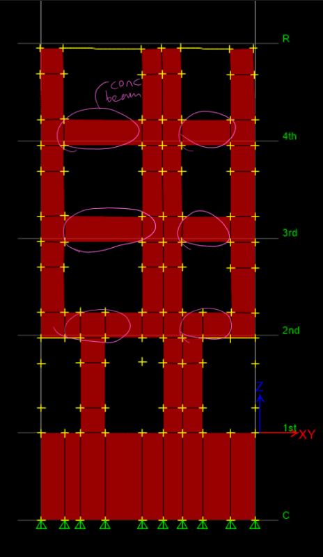

I'm designing a CMU wall as a moment frame. It's an existing 8" reinforced CMU wall (with 4" brick face) that needs to be upgraded for lateral. I'm going to replace some of the horizontal "CMU beams" with concrete beams. Anyway, do I need to check diagonal shear around the window openings? And if so, anyone know how to do it in ETABS or by hand?
I do need to do other things, like adding rebar and grouting cells. I know how to do all that stuff, but I'm just not sure about diagonal shear. Cracks around windows are pretty common in brittle materials, and moreso when it's part of a lateral system.

1) I would check diagonal shear cracking. I'd expect that to be the governing failure mode in most of your pier elements.
2) I believe that you'd check diagonal shear cracking in your wall bits the same as you would for any CMU shear wall / beam thing per masonry code so long as you're not high seismic (NYC).

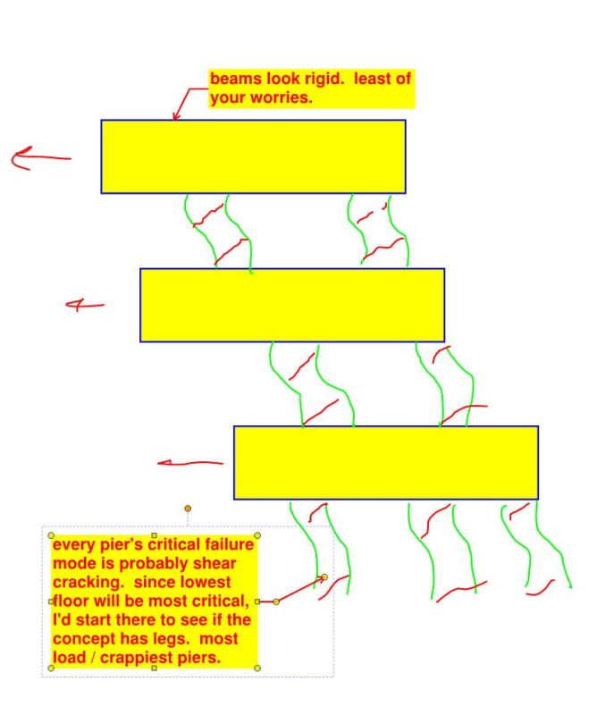

My gut feel is to see it like this out of the gate.
Just a concept to ponder. Probably impossible to do the CIP pier replacement without disrupting of the finishes behind those piers. Given the contributing seismic weight that would be taxing the low piers, I really can see those being tough to make a go of. I feel as though the upper levels could be justified.

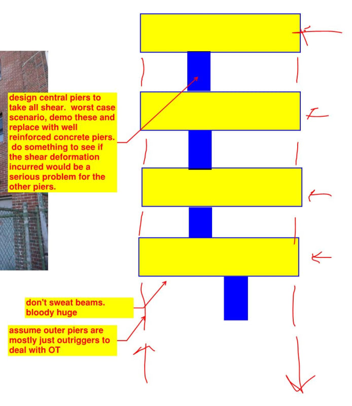

Interesting. I was just planning to just make the horizontal pieces between piers as concrete.
I wasn't considering doing it to the whole thing, which might be a better idea. Definitely works better as outriggers.
Yeah, the lower piers will have a hell of a time in shear. I think full concrete replacement might be impossible, but I might be able to put 4" concrete epoxied w/ rebar on the side of it, similar to FRP reinforcement. I did mention that I plan to use the exterior piers as outriggers, and they accepted it preliminarily. It'll be a lot of pages of calculations.
