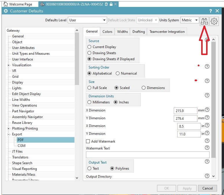

Go into your Customer Defaults and hit the binoculars on the upper right side.
Enter WATERMARK and there will be a couple places you may be able to go to change what you need.
