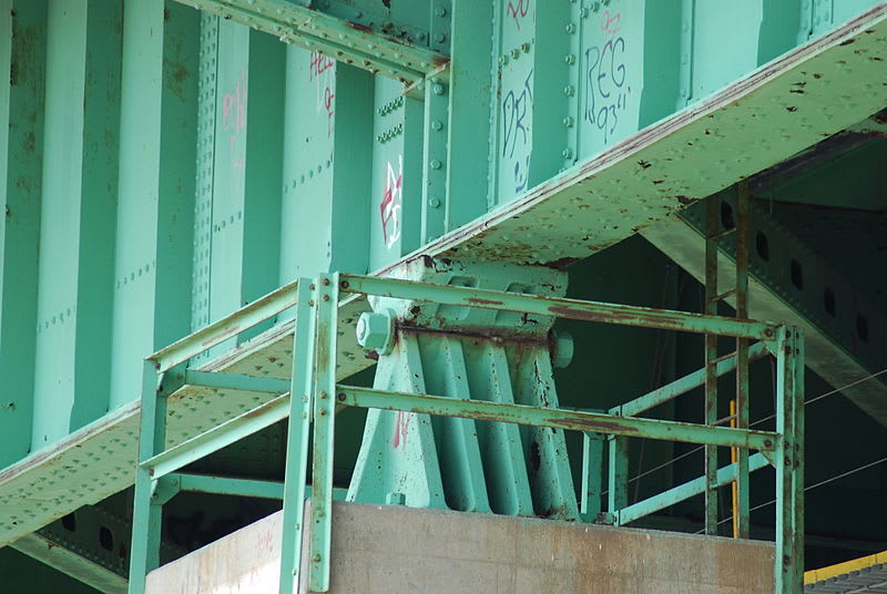

If axial loads are very high then you may need a rocker type connection. However I really doubt you'd require this unless axial loads are high and you REALLY need a well behaved pin connection.

For it to be a pin, the flanges would have to be able to lift off of the support plate, which they can't.
