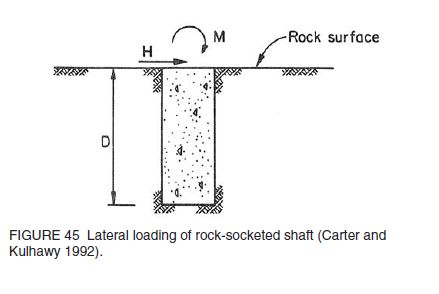

I preferred rock socketed pier with 3m separation and depth was about 1.5 m . ( The design is similar to the precast socket foundation design ).
I will suggest you to look ,
- Foundations on Rock (Duncan C Wyllie )
- Rock-Socketed-Shafts (nchrp_syn_360 )

Gut feel is that it's possible but I don't like the look of it - I prefer the surety of a proper footing or a rock socket
