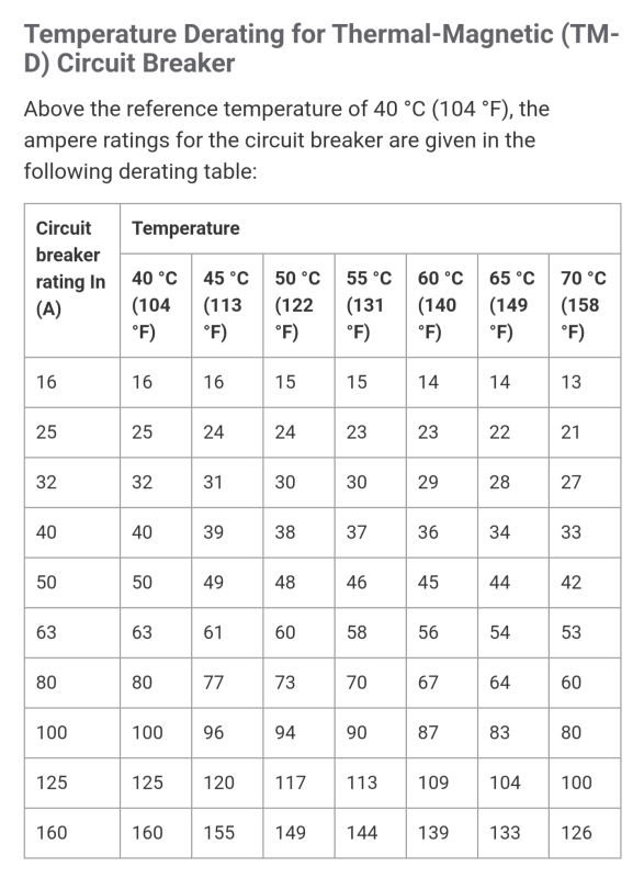

Even at 150°F, the trip derate isn't going to be more than 50%. Here is an example from a Square D t/m breaker.
That's for external ambient temperature Tug.
That chart is not valid for internally generated heat or heat conducted from a hot bus bar connection.
If you stay on the tugboats long enough, you will eventually see a good example of a bad connection causing premature trips.
I can remember the first time that I saw a heat related trip.
I can also remember much further back than that, when I had not seen it yet.
