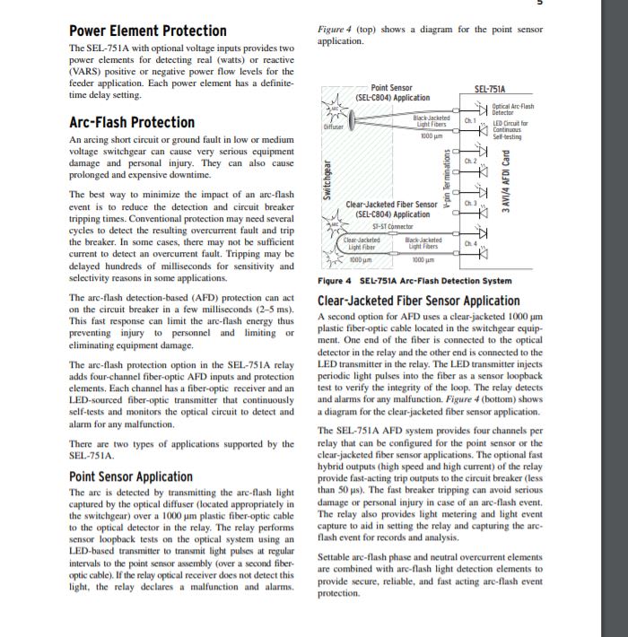

We have a proposal where he's showing 3 - 200/5 CTs on the primary, and CT's on the secondary. And he's calling that differential protection that will protect the switchgear. We weren't expecting the secondary CT's. Is this a common installation now ?

For a switchgear you could get arc flash detection on the 751 series. I *think* it’s the 751A.

Although still a bit confused here if this is for arc flash protection - which is what he's saying. Looking at the manual - that's done with fiber optics installed in the switchgear - not current sensing through a CT.

The design is improved overcurrent protection to reduce arc flash incident energy. The existing sub has high side fuse protection which will be slow in interrupting a fault in the switchgear. The modified sub adds a high side breaker and low side CTs to allow fast tripping for low side switchgear faults. This is a common solution for high arc flash incident energy situations.

The 751 and 751A can't do differential, so it's wrong to be claiming that. Both can only take 3 phase CTs and a zero sequence CT.
The 751A can do arc flash protection with fiber optics. We use it quite a bit and stock rolls of fiber for such installations.
