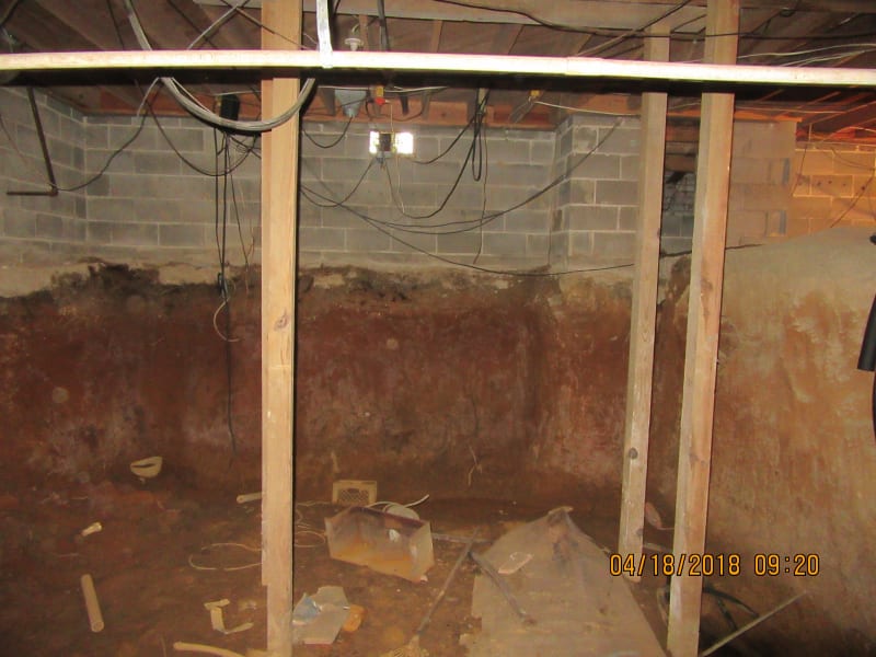

Trying to evaluate a Rubble Foundation basement wall. The house was constructed in 1850. Wall looks like it was a dugout(stones placed against the earth). Wall was also underpinned. No information on that. Drainage concerns will be eliminated, but would like to provide some type of reinforcement to the wall. Thinking of placing steel soldier beams to the concrete underpinning and floor beams above.
Appreciate any comments or help. Any documents?
 https://files.engineering.com/getfile.aspx?folder=bc74205e-ebf3-42d2-be10-9a0f70ffec83&file=DSC_1144.JPG
I would support the structure and excavate out and pour concrete. Dont add a maintenance item to a maintenance item.
Is this an "old mechanical basement" that someone later added a concrete slab and curb to? That is what the pic looks like. It does not look very tall so vertical ( I assume that is what you call soldier) beams should work ok. The right wall looks straight but the left wall looks kind of "bulgy". I would space the columns closer than normal since you have no real continuity in the stones as opposed to masonry block with poured cells.

The homeowner indicated that he observed the movement along with water infiltration about 18 months after purchasing the home. Comparing it to photos by the home inspector at time of purchase, movement is new. I first said to start with directing the drainage away from the exterior side to the home. Wall is 16-18" thick and about 6' tall with the soil level at the same height.
That's going to be a tricky one, unless you can find a way to support the structure above without touching the wall. A colleague of mine who saw the picture and I both fear removing even one stone anywhere could result in the whole wall collapsing. I think regardless of the repair strategy, the first step is to shore it. If the opposite wall isn't too far away, you could possibly brace it straight across. If not, maybe you can drive or auger posts to brace to, or dig a trench and brace against the back wall of the trench, or fill the trench with concrete and brace to the concrete.
If you leave some gaps in the shoring wide enough for a post, you can cut out a slot and put in posts or screw jacks to support the structure above while you remove the wall. Another option for that approach is keeping the top of the shoring down far enough to create pockets at the top to run beams through and support the ends on screw jacks inside.

The left wall is also an exterior wall as well as the opposite wall. These walls do not show any signs of distress. The subject wall was receiving water from the terrain up gradient.
How confident are you that hammer drilling the base plate anchors will not cause a collapse due to the vibration? I have no sense of how "delicate" the current condition is. Once you get at least one soldier in, the wall stability gets much better and you can work each direction from there. Problem is, getting the first one in.
I would not be confident doing anything to or near that wall until it's shored up. Vibration or shifting any one of the stones could destabilize the whole thing, burying whoever happens to be in front of it.
I will give the following advice based on having repaired several really bad basements with similar problems but I have NEVER had one that appears this unstable. I have never repaired a stone one that "has a pot-belly worse than mine". I acknowledge in this preliminary design that I am not able to see your actual situation but at least this is a starting point. Not only have I designed several, I have personally installed 3 repairs. The worst one I have repaired I actually bought in bad condition. I could put my hand in the cracks. This is a possible repair that is in need of scrutiny by others.
Absolutely #1-If the weight of the house actually sits on the stone wall, I would do nothing that lifts the weight off the stone wall. Lifting the weight could collapse the wall. If I had to, I could explain why I think this. Your picture looks like the weight of the floor sets directly on the wall. You can support the floor but DO NOT lift it.
#2-Unless the Owner has deep-deep pockets, I would explain that my "possible poor man's solution" is not fool proof and any risk is his, not mine. If they have deep-deep pockets, I would take another avenue. Get it in writing. The problem here is that the wall is unstable and therefore unpredictable. No matter what you choose to do, there could be problems. Even supporting it to remove and replace the wall has risks.
#3- I would not vibrate or do anything that creates a force near the wall. I would start "the collapse distance" away from the wall and work towards it. It would be prudent to install some temporary floor supports away from the wall but again, do not lift the floor. You need to make a safe area to work in general.
#4-Your floor joist are parallel to the wall, so install 1 set of solid blocking between the 2 joists nearest/centered on the stone wall. This should not create any excessive forces. It would be located at the middle of the wall.
