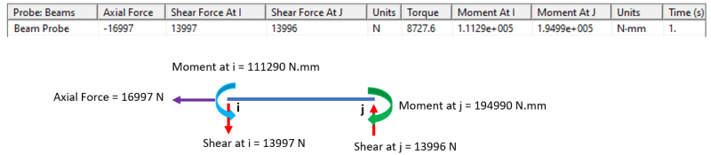

I tried to perform some tests with the modelling of bolt elements as beams, in order to assess the bolts with some code check, but i can't figure out how to include this bending moments in the calculation.
In the image bellow you can find the reaction probe of the bolt simulated as beam element. I can't understand from where it comes from this moment difference, once when I tried to calculate the moment from the shear force the values are different.
I made an sketch with the forces/moments that I think are related to the probe values.
Any idea?
The length of the beam is 13.5mm and the diameter is 20mm. In reality i need to sum also the thickness of the shell elements (15mm)in the length, but I not sure if its relevant here.
From the probe values, which approach do you suggest to perform some code check? Consider only axial and shear forces and neglect the moments?

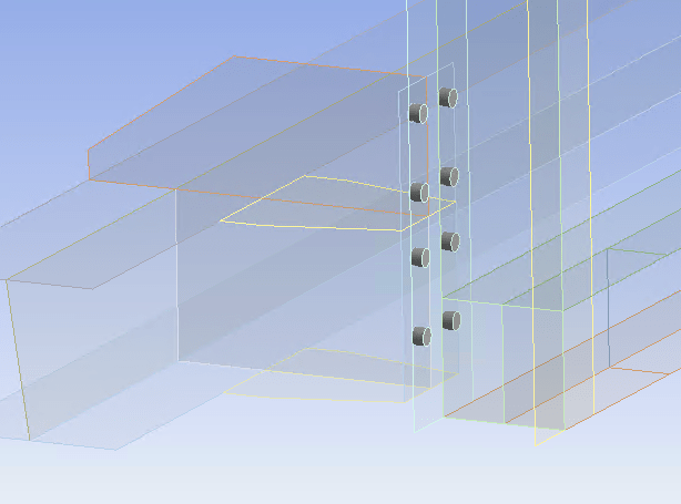

Can you provide sketches that show the connection and connected parts, also indicate the applied forces?
r13, basically I have two rectangular flanges and the bolts that connects them are beam elements (line bodies). The flange is reacting to the movement of a structure. Unfortunatelly i can't provide you the full picture of the project.
The values I include in the topic were just an example of how ansys provide the Force/Moment probe for a beam element. From these values I'd like to assess the bolts with code check.
yes, you see your problem …
shear = 14000N
beam L = 13.5mm
moment reacted at each end = 14000*13.5/2 = 95000 Nmm …
so, your problem is by modelling a beam and then having to fix the ends your bolt is "sucking up" moment.
did you try releasing the moment ?
model fastener as an RBE and/or a CBUSH
rb,
Just a note - the shears are opposite to each other, a couple, so the moment should be 190000 N-mm. Please correct me, if I am mistaken.

I can't use the end-release, since I don't have a line body. The beam is created from the edges of the flange shell element (as per image above).

I think the flanges of structure 1 and structure 2 are "linked" (3D of freedom), not rigidly connected (6D of freedom). I don't know what element is available to model the rigid link.

I already use this solution (bolts as beam elemnts) in different applications where the axis of the bolt was aligned with the load, and in this case the moments were irrelevant. The problem arose when the axis of the bolt was orthogonal to the force (images above)
