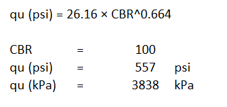

Is it that CBR of crushed limestone is 100?
Yes, usually road base crushed rock has a CBR of 80+ and typically in the 100+ range . . . CBR is designed for roads NOT,in my view, for structural foundations.
OK thanks.
Why is the output an order of magnitude higher?
Or is the formula not applicable?
This isn't a direct answer but, we're a conservative bunch and I'd guess 90% of the geotechnical engineers I've worked with wouldn't give more than 400-500 kPa ultimate for a shallow foundation without very good reason (extensive site investigation program, load testing, etc.), and certainly not more than 1000, regardless of what the equation tells you. I don't know if this is actually true since I haven't been to court myself but I was told if you give 100 - 150 kPa allowable it's very difficult to get to messed up in a court unless you gave 100 kPa allowable for some thawing muskeg.

I don't yet believe the value from the equation above but wanted to know why the large difference from the suggested 300-400kPa and 10x this from the equation.

Your crushed limestone is not carrying all the load itself - it is distributing the load down onto your natural soil consisting of clayey sand. That is the reason you wouldn't design to the bearing capacity of the crushed limestone.
For stability reasons, your plinth or footing is normally a minimum size anyway, so it generally doesn't make much difference to small foundation design whether you adopt a bearing capacity of 300 - 400kPa (which is probably reasonable) and 1 - 2MPa (which is ambitious and could come with problems- settlement, punching through of your plinth).
So there is good value to keeping the design bearing pressures within a proven range. It's not that you can't go higher, it's just that by doing so you open up a number of potential problems that need to be carefully analyzed by the geotechnical guys.

If you had a 10 meter thick layer of crushed limestone and underneath was basalt or something then yeah probably. Even if the friction angle was 45 degrees you should be around 3000 - 4000 kpa
