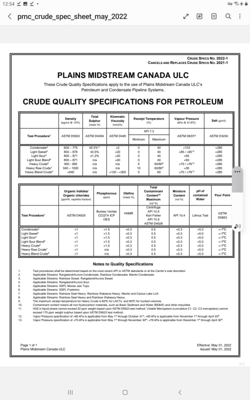

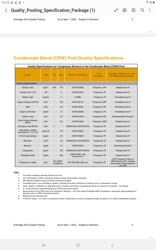

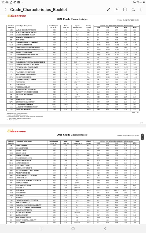

What will your downstream pipeline accept? Crude is generally limited to 100 kPa. Over that and you get into NGLs. No methane can be in NGL, nor much oil. Some only accept crude, some only NGL, some only gas.
Not the least of which could be marketing concerns, price and treating. What price can you get for crude with Vapor Pressure limits < 14.55 psia, crude-condensate with > VP, vs separating into crude and NGLs. Is separation and treating a better ROI.
All in all, I am not a fan of B31.4 when VOC are concerned, but if you want to install bullet tanks instead of atm tanks, why not. Just pay attention to public safety, hazard distances. I don't thing mixing atm tanks with bullets and spheres is good practice, but it can be done.
Typical crude pool limits
