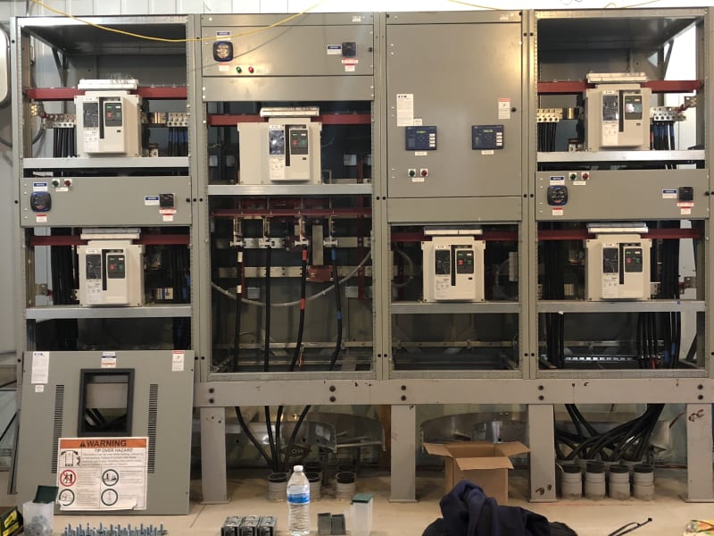

Yes you can.
We shipped a couple of MCC's with ASCO transfer switches installed recently. A few months back we built a main-tie-main switchboard with 2 ASCO transfer switches for generator power. 2 utility feeds and a generator, with the ability to change to two generators in the future.
