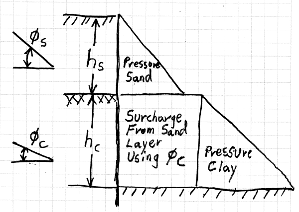

I am designing a shoring shaft with sheet wall and I thought it will be straight forward.
My soil profile is layered 50/50. the top half is sand (fill) and the bottom half is clay.
how can i get the apparent earth pressure to design the struts? is there a specific way to use for layered soil?
Thank you.
1) Pressure from sand is calculated the normal way.
2) Sand is considered a surcharge on the clay - use phi for clay to compute the surcharge.
3) Pressure from clay is calculated the normal way.

HanStrulo, SRE has it right for the theoretical earth pressure. However, you mention "apparent earth pressure." If you have a braced or tiedback sheeting/shoring wall, the apparent earth pressure diagram may be trapezoidal or possibly rectangular. Therefore, you will need to convert the theoretical pressure diagram to a rectangular or trapezoidal diagram. Calculate the total area (load per LF of wall) under the theoretical diagram and increase it by 20% to 30% (I use 30% per AASHTO). Then, form an apparent pressure diagram that has the increased, total area (load).
